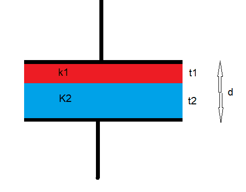

Between the plates of parallel plate condenser having charge Q,a plate of thickness t1 and dielectric constant k1 is placed.In the rest of the space,there is another plate of thickness t2 and dielectric constant K2.The potential difference across the condenser will be.
C=kAe0/(d-t+t/k)
k----->dielectric constant
A--->Area of the plates
e0---->permittivity
d---->distance between the plates
t------>thickness of the plate
V=Qnet/C
Combination of capacitors with materials of dielectric constant K1 and K2 is obtained.i am not sure if this parallel or series connection.
My logic says they are in series.
So Cnet=C1C2/C1+C2
But i am not arriving at a final answer

Your logic is correct, they are in series. Also your formula for the equivalent capacitance is correct. So now what are C1 and C2?
Yeah but isn't the distance between the plates of C1 d/2 ?
Not on my reading of the Q.
Abhimessi10 said:
... ,a plate of thickness t1 and dielectric constant k1 is placed. In the rest of the space,there is another plate of thickness t2 and ...
the dielectric plates are thickness t1 and t2 and they filled the gap d between the plates, so that t1 + t2 = d
It is not stated that t1 = t2
IMHO, the question is both incomplete and ambiguous but, given the information provided, can only be solved as 'C in Series'.

You can have the gap in the bottom half of the capacitor be completely filled with one kind of dielectric and the top half filled with a different kind. Is that what you mean? (Not the case here).
I thought that's exactly what we have here? EDIT: Except that it's not halves
That's exactly my interpretation.
