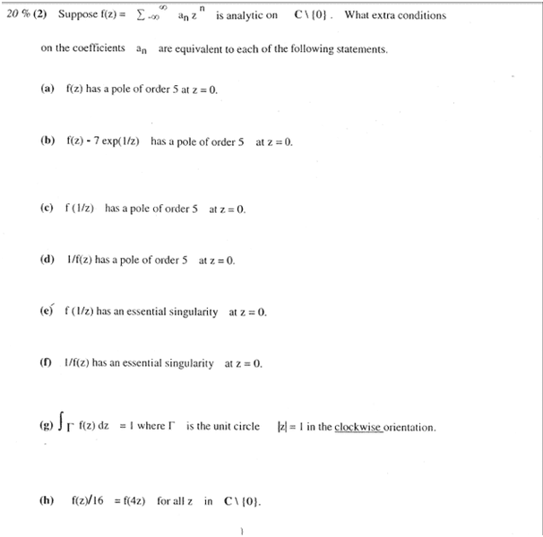

I have some past exam questions that I am confused with
[itex]a_{n} = \frac{1}{2\pi i} \oint_\gamma \frac{f(z)}{z-a}\, dz[/itex]
I'm not sure how to approach this, I'm completely lost and just attempted to solve a few:
a) it says [itex]f(z)[/itex] has a pole of order 5, so [itex]f(z) = \frac{g(z)}{z^5}, g(z)\neq0[/itex]
so then I guess the condition is [itex]a_{4} = \frac{g^{(4)}(0)}{4!}[/itex]? But that's just applying the formula for the coefficients...
c) [itex]f(\frac{1}{z}) = \frac{g(\frac{1}{z})}{z^5} => f(z) = z^5g(z)[/itex]
so the coefficients are [itex]a_{n} = \frac{1}{2\pi i} \oint_\gamma z^5g(z) dz[/itex]?
d) [itex]\frac{1}{f(z)} = \frac{g(z)}{z^5} => f(z) = \frac{z^5}{g(z)}[/itex]
so, [itex]a_{n} = \frac{1}{2\pi i} \oint_\gamma \frac{z^5}{g(z)} dz[/itex]
g) [itex]a_{-1} = \frac{1}{2\pi i} \oint_ \gamma f(z) dz = \frac{1}{2\pi i} = Res(f; c)*I(\gamma; c) = -Res(f; c)[/itex]
h) [itex]\frac{a_{n}}{16} = 4^{n}a_{n} => 0 = a_{n}(4^{n} - 4^{-2}) => a_{n} = 0[/itex] or [itex]n = -2[/itex]for e) and f), I'm not sure what the relevance of the essential singularity is
Well, I think you can see I'm clearly lost, would appreciate if you could help me out.

You need to look at these by sayin' for example, (a), if
[tex]f(z)=\sum_{n=0}^{\infty} a_n z^n+\sum_{n=1}^{\infty}\frac{b_n}{z^n}[/tex]
and it has a pole of order 5, then that must mean it at least has a non-zero term for the [itex]\frac{1}{z^5}[/itex] term and all the other terms [itex]\frac{1}{z^n}[/itex] for n>5 must be zero else the pole would have a higher order. Ok, I'll do some of (b) same dif:
If:
and [itex]f(z)-7e^{1/z}[/itex] has a pole of order 5 and I know that [itex]e^{1/z}=\sum_{n=0}^{\infty} \frac{1}{z^n n!}[/itex], then that must mean the terms of f(z) would have to be what to cancel all that out except for at least the [itex]\frac{1}{z^5}[/itex] term?
Ok then, do that same thing with all the rest.
