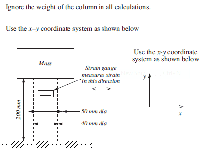

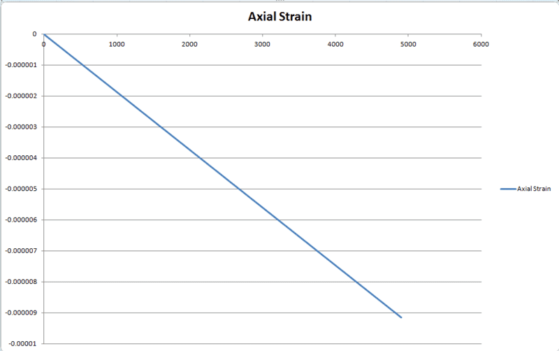

A tubular column supports a mass as shown in the diagram below. A
strain gauge is placed transversely on the outside diameter of the bar to
act as a load measuring device.
The column has an outside diameter of 50 mm and an inside diameter of
40 mm. The modulus of elasticity of the tube material is 250 GN m–2 and
the poison’s ratio is 0.33.
Q. Sketch a graph of the expected strain against the applied load, for a
load range from 0 to 500 kg. Make load the horizontal axis on the
graph and strain the vertical axis.

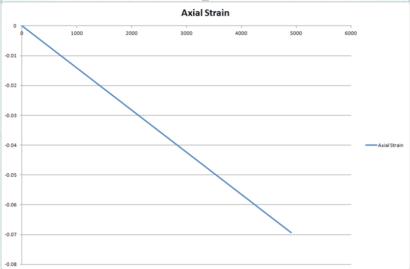

ok so i had another go, changing the modulus of elasticity. The graph looks much the same as before.
Does this look correct?
Please show us your numbers for 500 kg. Also, aren't you asked to plot the transverse strain, rather than the axial strain? Also, the axial strains are negative, and the transverse strains are positive.

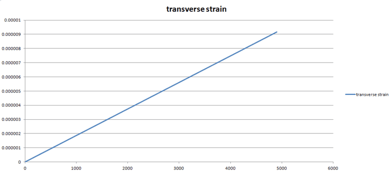

here are my numbers for 100Kg to 500Kg. apologies for the formatting.
Graph looks like this

If this is the case, then the normal stresses in your table should be negative, and the normal strains should be the same as the longitudinal strains.
ok I've had a rethink and changed the table. I'm a little confused as I believe the transverse strains should be positive in value. however it is showing as negative.

The transverse strain should be opposite in sign to the longitudinal strain. If the cylinder compresses axially, it must expand in the radial and circumferential directions. That's what your Poisson Ratio equation says.
Chet

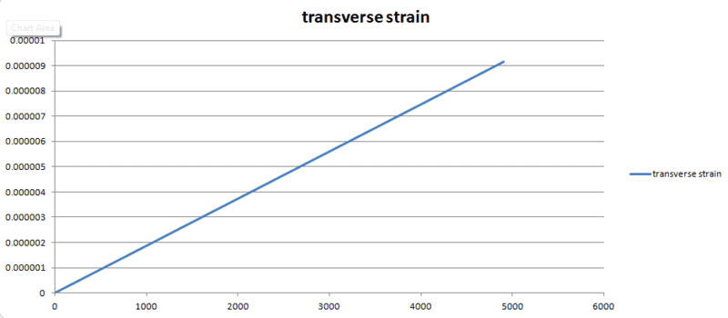

ok. So i changed the signs. I now have these figures and the graph is below. Does this now look ok?
Load(Kg)| Load(N) | Normal Stress | Normal Strain | Transverse Strain | Longitudinal Strain
100 | 0981 | -1387831.118 | -5.55132E-06 | 1.83194E-06 | -5.55132E-06
200 | 1962 | -2775662.235 | -1.11026E-05 | 3.66387E-06 | -1.11026E-05
300 | 2943 | -4163493.353 | -1.66540E-05 | 5.49581E-06 | -1.6654E-05
400 | 3924 | -5551324.470 | -2.22053E-05 | 7.32775E-06 | -2.22053E-05
500 | 4905 | -6939155.588 | -2.77566E-05 | 9.15969E-06 | -2.77566E-05
Looks good.

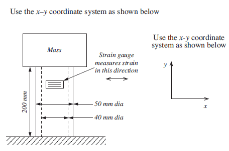

Show with the aid of a diagram how the orientation of the strain gauge could be changed to provide a greater strain for the same load. Sketch a graph of strain against applied load when the strain gauge is in
the new position.
I'm thinking that maybe the strain gauge could be mounted at a 45° angle. But would this give greater strain for the same load? Or am I over thinking this and should it just be mounted vertically?

Have you learned how to express the strain in an arbitrary direction in terms of the components of strain in the principal directions? Is the question asking about the absolute magnitude of the strain in an arbitrary direction (i.e., irrespective of its sign) or about the actual strain in an arbitrary direction? I can see why you are confused.
I have nothing in my learning material that details anything like that.
here is the question:
Well, OK, if you're talking about the absolute magnitude of the strain, and not whether it is extensional or compressive, then you can mount the strain gage in the vertical direction. That will give you the maximum absolute magnitude. However, if you're including the sign of the strain, the maximum value of strain is in the circumferential direction.

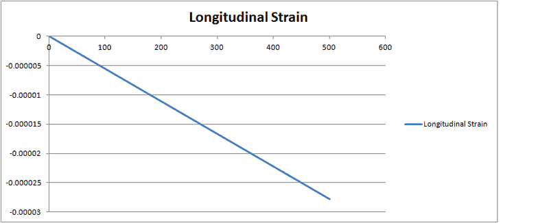

ok so first question. you should be looking to mount the strain gauge in the Y axis, (ie vertically) this will allow for greater sensitivity as the load is being applied in the Y axis. simply redraw the diagram but change the strain gauge position to vertical.
Thought that and done that so relieved that is correct. Now from doing that and the data earlier contruct a graph with the axial strain values, would this be correct for question 2?? If it is my graph is a wavy line...
the graph should be a straight line. it should look the same as the first graph.
you should first calculate the normal stress
then calculate normal strain
from normal strain you can calculate the Transverse Strain
then from the Transverse Strain, calculate the Longitudinal Strain
