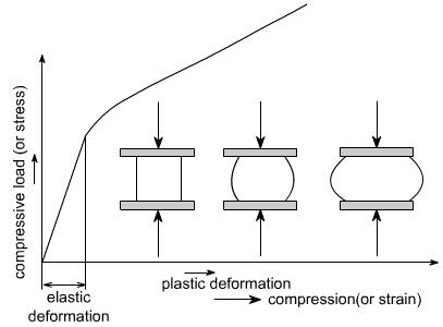

1. What is the difference between elastic and plastic deformation?
Elastic deformation is temporary and reversible, meaning that the material will return to its original shape once the applied load is removed. Plastic deformation, on the other hand, is permanent and non-reversible, causing a change in the material's shape even after the load is removed.
