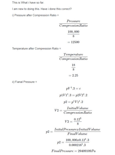

Air with an initial volume of 0.12m³, pressure 1 bar and temperature 18°C is compressed according to the law pV1.3 = c through an 8:1 compression ratio. It is then allowed to expand isothermally back to its initial volume. Determine:
i) the pressure and temperature after compression, and
ii) the final pressure.
For air, take R = 287 Jkg¯¹ K¯¹.
Is my solution correct?
Thanks
Thanks
1. Compression ratio is defined as the initial volume divided by the final volume, not the final pressure divided by the initial pressure.
2. The pressure-volume equation they gave you was supposed to be ##pV^{1.3}=c##, not what you used. This means that the temperature was changing during the compression.
3. Your calculation of the temperature was incorrect, because the volume was not constant. You didn't need to determine the temperature. You need to determine the pressure after the gas is compressed, given the initial volume and pressure, and the final volume. This can be done with the p-V equation they gave you.

For step 1, you have $$p_{1f}(V_{1f})^{1.3}=p_{1i}(V_{1i})^{1.3}$$
where ##p_{1i}=100000\ Pa##, ##V_{1i}=0.12\ m^3##, and ##V_{1f}=0.015\ m^3##. So, $$p_{1f}(0.015)^{1.3}=(100000)(0.12)^{1.3}$$
From this equation, what value do you get for the final pressure from step 1, ##p_{1f}##?
