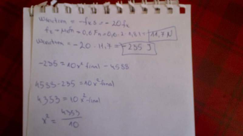

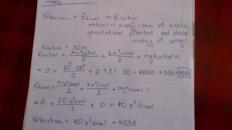

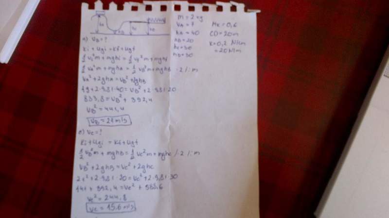

Hi again
I try to solve this by my own with little help from the net, but still I'm not sure if it's the correct!
Here is my work, and please someone tell me if I'm wrong, again. (x = 20,8 m ?)
Thanks
P.S. Here is the full problem http://i.minus.com/j8Fbhtd9CJtCQ.jpg
  • Handwritten physics working on lined paper: Work = E_final - E_initial, with energy as kinetic, gravitational potential and elastic spring energy; h_initial = 30 m, E_initial = 0 + 20*20^2/2 + 2*9.81*30 = 4000 + 588 = 4588, E_final = 20x^2_final/2 + 0 = 10x^2_final, giving Work = 10x^2_final - 4588.
  • Handwritten work on lined notebook paper showing friction work calculation: Wfriction = -fk s = -20 fk, fk = mu N = 0.6 Fn = 0.6 * 20 * 9.81 = 117.7 N, Wfriction = -20 * 11.7 = -235 J, then -235 = 10 x^2 final - 4588, 4353 = 10 x^2 final, x^2 = 4353/10.

  • Handwritten physics solution on lined paper: energy conservation steps for finding v_B = 24 m/s and v_C = 45.6 m/s, with given values m = 2 kg, h_A = 40 m, h_B = 20 m, h_C = 30 m, and related quantities listed at right.

Some parts of the problem text are washed out, and the solution is out of focus. I don't think you want any guesswork on our part, so you should give us something more readable if you need help.
Here, more readable:
A sledge of mass m=2 kg starts with initial velocity Va=7 m/s at ha=40m. Compute, neglecting friction.
a) the speed Vb at hb=20m
The sledge then travels from C (hc=30m) to D horizontally on a rough surface with uk=0.6.
From D the surface becomes frictionless. In E a spring in equilibrium condition (i.e. neither streched nor compressed) is positioned.
b) Determine the maximum compression of the spring, knowing that CD=20m and the spring constant k=0.2 N/cm.
PE+KE=Wf+PEs
mgh + 1/2 mv2= mgμd + 1/2 kx2
Check for zero PE reference level.
Gravitational force is conservative, only levels are relevant not the path between the levels.

Why is h = 10 m and v = 7m/s? I computed the velocity at C to be 15.7m/s and the motion is at a height of 30m. (I took the reference of zero potential at ground level).
As i mentioned on previous reply, it is a conservative force. It is not he path but the different of height that determines the ΔPE. So the ΔPE is height between A and C.
Conservation of energy. The kinetic energy remain the same. As in projectile, the horizontal velocity remains constant.
From point A to C no energy dissipated.
add: If level A equal to level C, do you need to take zero reference at ground level?

There are too many steps here that cause errors. Eliminate all the intermediate steps. Start at A and end at E. [itex] (KE + PE)_{initial- at- A} + W_f = (KE + PE)_{final- at -E}[/itex]
Work done by friction is numerically a negative value.
So, guys, what is the final and also the right result?
Oh heck you have a good understanding of work energy concepts, so it's just math now for the 2nd part and using g = 10 , then
1/2(2)(7)^2 + (2)(10)(40) + 0 - .6(2)(10)(20) = 0 + 2(10)(30) + 1/2(20)(x^2)
From which x = 1 m.
Which looks like what azizlwl got using a slightly different approach between a different set of points. You should confirm this on your own, as there are lots of ways to skin a cat, as they say.
Oh sorry I didn't pay attention to part A I guess that's solved already.
Okay, the part a) is just fine, no problem at all with it...
Many thanks to everybody, I hope the answer of 1m is correct :P

At point A only energy for the system is kinetic energy with velocity of 7m/s.
From point A to point C, gravity has done work on the sledge equal to mgh.
No energy is taken out from the sledge ONLY added work by gravity.
So at Point C we have original energy PLUS energy added by gravity.

I think you think I am the OP :) I just came in and did the question and azizlwl pointed out my error in the way in which I was forgetting to use potential energy. However, I am still unsure of why the velocity at C is 7m/s. Computing it gives a much larger value of about 25m/s. I computed it like: [tex]\frac{1}{2}mv_b^2 + mg(h_A - h_B) = \frac{1}{2}mv_c^2 + mg(h_C-h_B),[/tex] which when using [itex]v_b[/itex]= 21m/s yields [itex]v_c[/itex] as ≈25m/s. (reference of potential, 0 at ground)
See any errors?

Yes, if you are referencing the ground as 0 PE, then its mg (20) for initial PE at B, and mg(30) for final PE at C. I think you had it right the first go around, Vc is about 15 + m/s.....

Energy at A =KEA
Energy at B=KEA + ΔPEAB
Energy at C=KEA + ΔPEAB -ΔPEBC
Energy at C=KEA + ΔPEAC
Error in your total energy at Point B. v=vA not vB and vC should be vB

Ok, so using the velocity at C to be 15.7m/s, i have: [tex]\frac{1}{2}mv_c^2 + mgh_c = \frac{1}{2}kx^2 + mg\mu(CD)[/tex]. Putting in numbers gives x ≈ 7.7m?
Where is my error?
