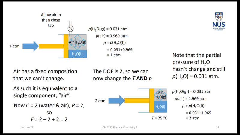

For example we had a closed system with water at 298K, so it's pressure is 0.031atm. To it we add a gas, A such that we get 1atm of total pressure. That gas undergoes a phase transition at 1.5atm and 298K. So initially, the partial pressure of water is a little smaller than 0.031atm due to the dissolution of some of that gas, and the rest of the pressure is from that gas.
As we compress this mixture of gases with 2atm of pressure what would happen? How would the A and water's partial pressure change?
Since A is able to increase its partial pressure further before liquefying, I feel that it should increase to 1.5atm. But that results in a decrease in the water's partial pressure because it's mole fraction in the liquid continues to drop further. So the total pressure will be 1.5atm from A, and less than 0.031atm from water. But then since we're applying 2atm of pressure, how does that equal out?
Something like the uploaded image but instead of air we replace it with a different gas.

Are you actually describing a stable final situation here? The final pressure in the cylinder has to be 2Atm .
I get that the final internal pressure has to be 2atm. But I don't see how that can be achieved with the parameters I've set because A would liquefy once it's pressure is at 1.5atm, and the water would liquefy at pressure less than 0.031atm ad well.

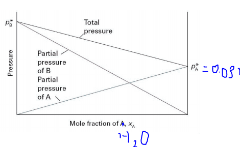

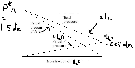

Oh, wait we can tell it from the graph right? So we would know that the exact pressures of water and A at a total pressure of 1 atm?
So it will look something like this right? So we can get the mole fractions of either component?
But continuing on, when we compress the gas with 2atm of pressure the mole fraction of water goes to 0? I don't really understand how the process continues on from here though.

We first have to specify how much water and how much A are present total. So, please specify. That way we can determine how much of each species is present in each phase.
