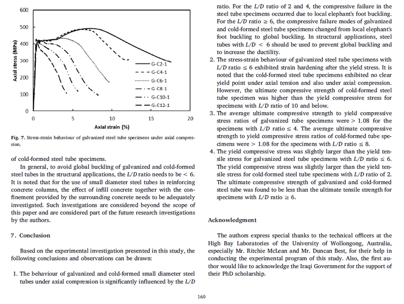

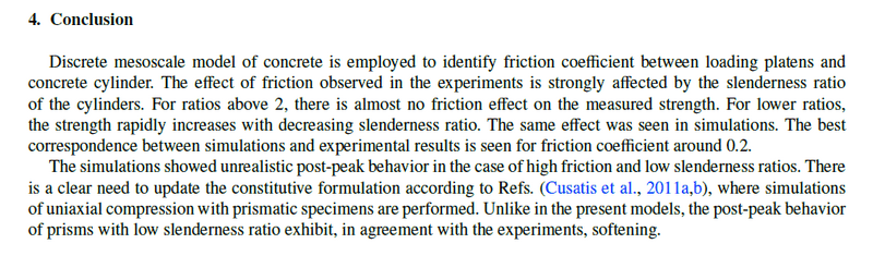

  • #59
Bone is not a ductile metal encased in concrete.
Rev. Cheeseman said:
the more slender (higher height-to-diameter ratio) the less the compressive force.
Exactly where in that dissertation, (line number), does it make that statement ?
  • #60
I can't find the compressive force when the fracture or failure begin, but only compressive strength.
I'm trying to find articles or studies that said the compressive force to break a whole femur is the same as breaking a midshaft only segment but still can't find it.
Saw some studies on concrete cylinders, like this https://www.researchgate.net/public...in_uniaxial_compression_of_concrete_cylinders. The conclusion below said...
"For lower ratios, the strength rapidly increases with decreasing slenderness ratio"
