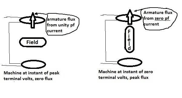

I am attempting to make a basic model of an alternator and determine terminal voltage levels at several different current levels.
The alternator design looks like this:
900 RPM fixed, 60hz, single phase
2000 gauss permanent magnet Flux Density, Magnet circumferential velocity 9.58 m/sec,
4 Coils w/220 turns each, 57.5 meters of 15awg/coil, 230m total
Total DC Resistance 2.4 ohms, Total Inductance 9.5 milliHenries
I compute open circuit voltage to be 121.1v RMS and 171.2 P-P.
As current begins to flow, I understand that back emf is generated as the load current is also moving in the magnetic field, but in opposition to the direct voltage generated.
I would like to calculate the back emf at 0.5, 1, 2, 3 and 5 amps load current.
I have searched the net for a method/formula that would allow me to calc the counter emf as the alternator load current increases, but I am not finding a good, reliable resource for this.
Any suggestions about resources or formulae to move this ahead would be greatly appreciated!Bruce

From an old old thread at https://www.physicsforums.com/threads/armature-reaction-drop.826513/#post-5191404Let's really simplify our thinking down to a synchronous machine with a one turn armature and a permanent magnet rotor.
We'll allow the complication that the rotor is machined to produce sine shaped flux, though.
Recall that voltage and flux have a derivative/integral relationship meaning our sine shaped flux gives a cosine shaped voltage
because e = - n*dΦ/dt
and cosine is 90 degrees out of phase with sine. That's a quarter cycle.
so--- peak voltage appears at the flux zero crossing
and zero voltage appears at the flux peak
because of that sine-cosine relation.
Do we all accept that unity pf current is in phase with terminal voltage ?
and zero pf current is 90 degrees ahead or behind it ?
We'll make our simple one turn machine with only one pole pair so electrical and mechanical degrees are the same, 90 deg = ¼ turn.
Okay,
please -
pardon my crude sketch i just don't do well with computers.
The circles are my one-turn armature windings. I've freeze-framed my thinking as mentioned earlier, so these would be like high speed photographs.
Left sketch:
Flux from armature zero pf(real) current is perpendicular to flux from field
so there is little interaction beyond a phase shift, and that's why there is a power angle.
At this instant, zero pf current is zero so it does nothing.
Right sketch:
A quarter turn later (or earlier) when unity pf (real?) current is zero
and reactive(zero pf) current is maximum,
look where the rotor is !
That's why zero pf current in the armature adds or subtracts directly to field flux. It peaks when rotor pole is right underneath the armature turns.
You should stick with the notation in your textbook
but i find this mental image useful to understand why there's such a thing as synchronous reactance. It's not same as leakage reactance.
It does affect terminal voltage by reducing flux in the machine(,or raising it )
but the external characteristics are same as if it were another circuit element
and that's how most authors present it.
Is that any help ?
old jim

Bcavender said:
Help me catch up to where you are. I am confused by the reference to power factor. If the alternator had a purely resistive load, wouldn't the apparent power be equal to the real power?
Yes. That's unity power factor.
i am confused by your term "back emf" .
Resistance of the windings means there'll be an ohmic drop proportional to the current and in phase with it.
Inductance of the windings means there'll be a reactive drop proportional to the current and out of phase with it .
That's why you see phasor diagrams in all electric machinery textbooks .
Generators are described as an internal voltage in series with an inductance and resistance.
Bcavender said:
This back emf has to be the source of increased mechanical torque back to the prime mover as more electrical energy is delivered to the load ... to keep total energy in/out/lost balanced.
In DC machines, back EMF X armature current does equal power being converted
AC machinery texts use "power angle" .
Consider the rotor just a rotating magnet, as i drew up above. Its field rotates with it.
The stator creates a rotating magnetic field.
If the rotor is behind by the stator field and being dragged forward by it then the machine is acting as a motor.
If instead the rotor is ahead of the stator field and being held back by it then the machine is acting as a generator.
So it's that power angle between rotor and stator fields that engineers use as a measure of power.
That's a physical angle and you can watch it by synchronizing a stroboscope to terminal voltage and shining it on the shaft keyway.
Armature current will flow to make the sum of the two fields align with terminal volts.

It is a fact that in a DC machine the product of counter emf and armature current is the electric power being converted into mechanical or vice versa.
In an AC machine armature current distorts the field similarly, adding to it in the fashion of vectors and phasors.
If by "Back EMF" he means the voltage drop across what's called in traditional machinery courses "Synchronous Impedance"
he'll benefit from this online lecture or a similar one
https://www.slideshare.net/mkazree/chapter-4-synchronous-machine
Synchronous Impedance is sum of RS and XS .
Internal voltage EG is proportional to field strength which for a permanent magnet rotor is constant ,
he gave open circuit voltage of 121.1 volts so that's EG
Resistance of his stator winding he gave as 2.4 ohms so that's RS
He calculated stator inductance of 9.5 millihenries which at 60 hz is j3.58 ohms so that's a first estimate of XS
sum of those is 2.4 +j3.58 = 4.31∠56.2° ohms
so he could try solving the above circuit with those values.
Generators are described as an internal voltage in series with an inductance and resistance. In DC machines, back EMF X armature current does equal power being converted
