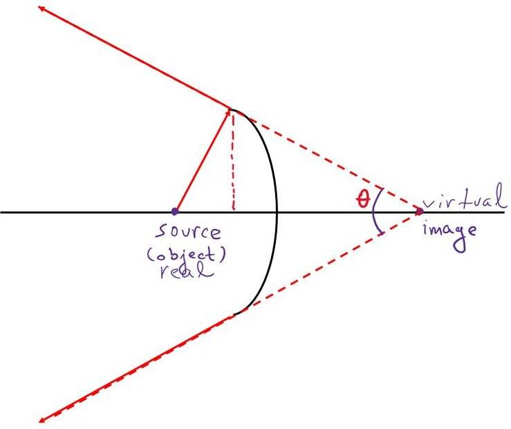

You are building a lamp using a concave mirror and a small lamp (point lamp) which is place on the optical axis at 10 cm from the mirror which have a diameter of 4cm. Knowing that the reflected beam have a 10 degree angle, what is the curvature radius of the mirror.

Consider the reflected beam as starting from the virtual image and going through the mirror, back towards the side of the source. The angle between the extreme rays is given.

The object is real, the light source. Behind the mirror is the virtual image.
Steve4Physics said:
I'm not sure about the Post #9 diagram. The lamp is meant produce a cone of light. The virtual image is at the apex of the cone. .If the cone-angle is θ (as shown here: https://undergroundmathematics.org/circles/cones/images/right-cone.svg) then the angle of 10º correspomds to θ or possibly 2θ - the question is unclear.
Looking at the drawing, it looks like the 10° is between the optical axis and the outgoing ray which would be the half angle of the cone, ##\theta## in your diagram.

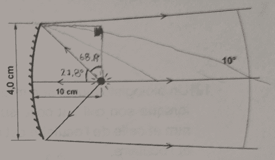

Yes... I think there is some line like the 21.8 and 68 degree angle, and the 2 really light gray line. The original question is in french, and it's for my daughter. Some of my Physics and Geometry are quite rusted.

The diagram may be something like this. It is not clear if the angle ##\theta ## is what is 10 degrees or just half of it. Maybe you post the original text, even if it's in french?

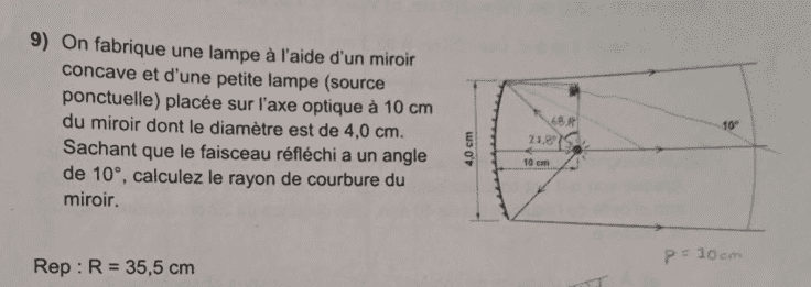

as requested, here is the original text... with the answer
Maybe whoever drew the Post #9 diagram should have marked the angle as '5º' rather than '10º'. The given value of 10º in the question could be the cone's full angle (2θ) or its half-angle (θ). As far as I can see, there's no way to tell which interpretation is correct.
Base on the french text, I assume the 10 degree is the full cone angle since it says "the reflected beam have a 10 degree angle", but I may misinterpreted it
With the 10 degree as the full angle I get their answer of 35.5 cm. So, I suppose that this may be the author's intention.
From the right triangle with angle of 5o (drawing in post 17) you can get the image distance ##d_i = \frac{2 cm}{tan 5^o }## = 22.86 cm which is actually negative (virtual image) according the sign convention which works for the mirror formula I will use in the next paragraph.
From the basic equation ##\frac{2}{R}= \frac{1}{d_o}+\frac{1}{d_i}## with ##d_o##=10 cm and ## d_i##=-22.9 cm, I get R = 35.5 cm.
This should be actually rounded to 36 cm based on the input data.
When we calculate ##d_i## we neglect the small distance between the vertex of the mirror and the vertical cord. But as the mirror is only 4 cm versus a radius of about 36 cm, the error is of the order of a mm. Anyway, the formula used above assumes paraxial approximation.
