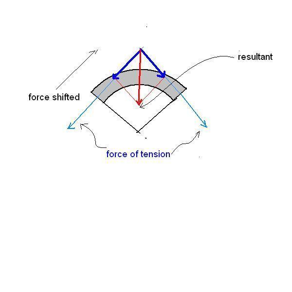

I have attached a picture .
The tension T is acting at the two ends of the arc AB (element ds) . The arc subtends an angle θ at the center .This makes the two tensions separately to be acting at an angle θ/2 with the horizontal .
The horizontal components cancel whereas the vertical components add up to give a net force F.
How is the net force F= 2Tsinθ/2 acting along the line joining the mid-point of this arc M to the center of the ring C ?
Are we considering the two tensions to be acting at the COM of the arc (which lies on the line MC) ? OR should we consider the two T's to be acting at the mid point M of the arc ?

It seems obvious to me, but I'll try to analyse it somewhat:
Three things completely determine a force: magnitude, direction (its two vectorial attributes) and line of action.
In vector terms, clearly the two individual forces add up to the one force of double the magnitude through M. If you consider torques about some point, the torques of the two individual forces add up to the torque of the one force of double the magnitude through M. There are no other considerations.
Once you have reduced it to the single force along MC, it does not matter at which point along MC you consider it to act.

Yes and no. They don't literally act at the COM of the arc since they act tangentially at the ends of the arc, but it is clear that their resultant will act along lime MC, so you can treat them as acting at the COM.
Sorry, but I am struggling to understand what your difficulty is. In the OP you correctly observed that the tangential components of the two forces cancel, leaving only the radial components, which you can add together.

If two forces have equal magnitude then their resultant bisects the angle between them, and passes through the point where the lines of action of the two forces intersect.

You know that the forces acting on a rigid body are equivalent with a resultant force (applied at the CM) and a couple.
In this case there is no torque, only a resultant force. See picture. The parts of the ring neighbour to the line element both exert force, tangential to the ring at the ends of the sector. You can shift these forces and draw their sum. In this case, the line of the resultant force goes through the middle of the orf the small arc and points at the direction of the centre of the ring.
