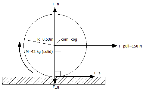

Hello, new poster here.
I have trouble understanding some friction/resistance properties and how they are applied to rolling & linear motion simultaneously.
I've done a lot of simple static / dynamic (sliding) friction examples as well as rolling without taking into account resistance, but somehow the combination seems somewhat counter-intuitive to me.
Free-body diagram of a solid cylinder on a horizontal surface: R = 0.53 m, com = cog, M = 42 kg (solid), F_pull = 150 N applied horizontally at the center, F_n up, F_g down, F_s friction at the contact point, and a curved arrow showing rotation.
Solid cylinder on a horizontal surface is pulled from it's center of gravity (cog = com) parallel to the surface with force [tex]F_p=150N[/tex]. See the free body diagram above. The known variables are:
[tex]R=0.53m[/tex] (radius of the cylinder end)
[tex]M=42kg[/tex] (mass of the solid cylinder)
[tex]F_p=150N[/tex] (force pulling the com of cylinder)
[tex]\mu=0.3[/tex] (friction coefficient between cylinder and surface)
Define the (linear) acceleration of the cylinder and the angular acceleration of the cylinder, when the friction coefficient between the cylinder and surface is [tex]\mu=0.3[/tex]

0. In a case like this, how do I identify (or do I _have_ to identify) what the given friction coefficient means? I assume it is for static friction, but can I infer it somehow?
1. In the image above (drawn by me, may be incorrect). The direction of the rolling resistance is in the same direction as the the force pulling the cylinder, trying to cause movement, right? (this is due to the fact that the rolling should be clockwise in this case and rolling resistance should resist that clockwise motion of cylinder's surface particles when touching the level surface, effectively preventing slipping up to a point).
Fix co-ordinate: Positive directions towards up and down.
Attempt 1.
[tex]\Sigma F=F_r=F_g-F_N+F_p-F_s[/tex]
The sum of forces is (resultant force): Gravity and normal forces are equal, but opposite in direction, force that pulls is resisted by the static friction force.
[tex]F_g=Mg[/tex], [tex]F_s=\mu F_N=\mu Mg[/tex], [tex]F_r=Ma[/tex]
[tex]F_r=Ma=F_p-\mu Mg \leftrightarrow a=(F_p-\mu Mg) \div M[/tex]

Recall that friction always acts to oppose slipping between surfaces. So which way will it act?
Static friction will be whatever it needs to be to prevent slipping, up to its maximum value. (So don't just assume that friction equals [itex]\mu N[/itex].) Set up equations for rotation and translation (apply Newton's 2nd law to each) and see if there's sufficient static friction to prevent slipping. Solve for the acceleration assuming no slipping.
