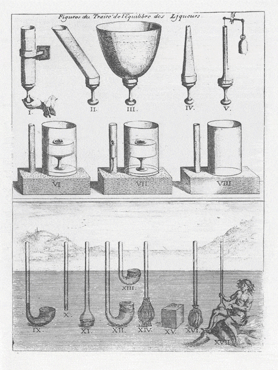

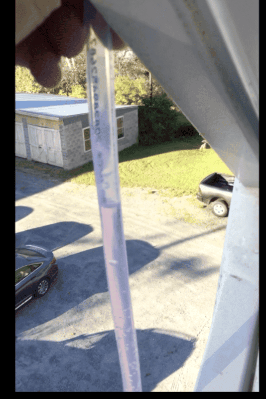

There's nothing more convincing than experimental evidence. When I teach this subject I start with a demonstration using "Pascal's apparatus" which shows that the force exerted by a column of liquid with a given base area depends only on the height and not the volume (and thus not the weight) of the liquid - a nonintuitive phenomena.
This is an image from Pascal's treatise. The top image illustrates the idea of the apparatus. No matter the vessel, it takes the same amount of weight to hold the plug (figure V.) as long as the heights are equal. In vessel III the weight of the liquid could be 100 lbs and in vessel V it might only weigh 1 lbs, but both will require (say) 10 lbs to balance the plug. I couldn't find a video of someone demonstrating the apparatus. Next time I use it I'll have to make one.

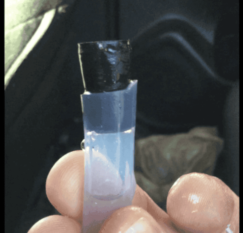

Others have answered this, and I can't upload the video, but here's as screenshot from a video I took of using water for a barometer. I used a bucket of water and a vinyl tube. I sucked the water through the tube so that the tube was completely filled and used a rubber stopper to seal one end. Then I went to the local fire department and they let me go up on their ladder truck until the water would not rise any further (about 30 ft as others have mentioned). Interestingly, you can see bubbles from the water boiling due to vacuum pressure of the "void" at the top of the tube. The video is much more impressive for that aspect of the demonstration. The second photo shows what I assume is gas that has not had the chance to dissolve back into the water, but others can correct me if I'm wrong.

... I went to the local fire department and they let me go up on their ladder truck until the water would not rise any further (about 30 ft as others have mentioned).
Wonderful!

brainpushups said:
There's nothing more convincing than experimental evidence ...
While painting the garage door I thought of a possible addition to your lovely experiment.
Ask the students to calculate how much the water in one foot of the tube weighs. And how much the water in 32 feet of the tube weighs.
Attach a spring balance to the top of the tube and record its readings as you ascend up the ladder and when you are at the top with a vacuum above the water level. You could ask them beforehand what they expect those readings to be.
The balance will show only the weight of the tube, not the weight of the tube and the water in it. It leads to a discussion of how does the water get into the tube and what is supporting the water.
