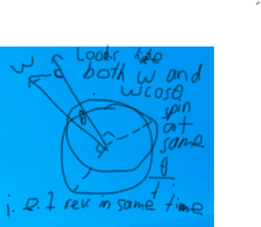

I'm pretty sure I'm tripping myself up.
n/a
Angular velocity is the degrees by which something rotates over a time period. If I have an angular velocity in one direction and I resolve it into its components, its components would obviously be of lesser value. Here's what I don't get. When I imagine this scenario, I see that the thing rotates the same amount of degrees per second in both the resolved component and the original vector. Help.
Angular velocity is a quite subtle concept. Try to rest on definition and theorems only
You have to tell us what exactly is the scenario you imagine. We can't read your mind :D:

If you are resolving angular velocity into components then I take it this is in 3D.
Unlike linear motion, angular displacements don't add, so looking at the angles of rotation over extended periods is not helpful. Instantaneous angular velocities can be added because the displacements are over infinitesimal periods.
Or have I misunderstood your question?

diagrams kind of sketchy tbh.
Also was wondering whether I could indicate a vector by just drawing a -- (bar) instead of an --> (arrow) to save time in exams.

So am I just meant to ignore the fact that 1 rev looks like it takes the same amount of time for the component and the original vector, and that makes it look like theta/t (angular velocity) is the same value?
I think your notion of resolving an angular velocity vector into components in, say, orthogonal directions is not in general valid.
Consider a particle executing constant circular motion around some axis X at rate ##\omega##. Considering its instantaneous velocity in respect of some axis X' at angle ##\theta## to X, its angular velocity about X' varies between ##\omega\sin(\theta)## and ##\omega\csc(\theta)##. Do I have that right?

I have the same problem with the statement that you made. Say that I switch axes, I still see the particle moving the same theta/t, that is 1 rev in the same time period and thus angular velocity remains equal?
It completes one orbit about the axis in the same time, but as I posted, the angular velocity keeps changing, so I think it is simply not valid to resolve an angular velocity into components in the same way as for a linear velocity.
However, it is ok to resolve angular momentum that way. In my scenario, the angular momentum comes out constantly as ##mr^2\omega\sin(\theta)##.

How exactly is it changing? I don't see why theta/t would be changing.

w1+w2. Where is the angular velocity changing? What statement are you referring to?

Yes, angular velocity vectors can be added and subtracted to find relative motion, but the OP's question is specifically about resolving a vector into components, as in sin and cos of an angle.
Consider the model in post #9. If a point is moving around the X axis at constant rate ##\omega## and radius r then the component of its instantaneous velocity normal to the plane containing it and the X' axis varies between a speed ##r\omega\sin(\theta)## at radius r and a speed ##r\omega## at radius ##r\sin(\theta)##.
Thus, its angular velocity around X' varies between ##\omega\sin(\theta)## and ##\omega\csc(\theta)##.
The OP worries that the time for the particle to complete a rotation about X and X' is the same, so in that sense the angular velocities are the same. My position is that resolving angular velocities in this way is invalid.

I might have failed to convey the scenario that I was thinking about specifically.
Here's where I started to think about it, for reference.
10:10 - 11:00, where z = omega cos theta is stated.
Yes, I see your issue with the method at that point.
But my issues start sooner. How did she pick that tilted axis for ##\Omega## in the first place?
I would have considered the motion of the system as the sum of a constant rotation about the z axis and a rotation about the axis of the rod, where that second axis varies over time.
At a given instant, yes, the angular momenta probably add vectorially to one aligned with her ##\Omega## axis, but that is not the same as saying the rotation vectors do.
As far as I can see, in her method, she could just as easily have calculated the angular velocity of the centre of the small disc about the z axis directly as its linear velocity divided by its distance from the z axis, getting a larger value than she got for the angular velocity about her tilted axis - instead of a smaller one.
This is exactly the problem I modeled in post #9, and as I wrote, you are much safer working with angular momentum vectors.

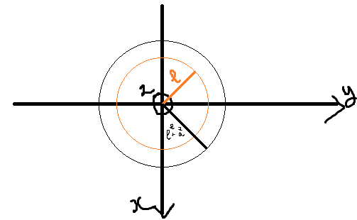

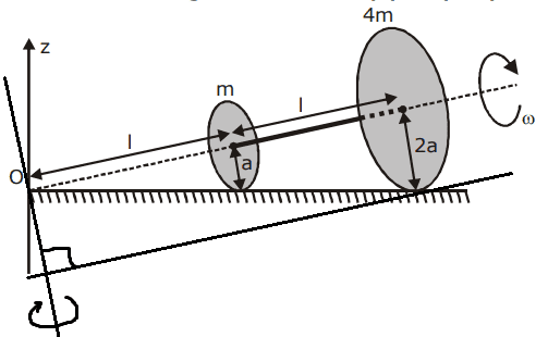

@aspodkfpo I answered that JEE question on stackexchange before, I'll try and copy/paste the question.
Interesting question, though I think that the questions could have been asked in a better way.
First, let met explain the angular velocity with respect to the ##z##-axis. If you look from atop, then you'd see something like this.
The smaller circle represents the projection of the position of the centre of mass of the disk onto the ##xy##-plane, while the bigger circle represents the actual path taken by the point of the disk which is in contact with the aforementioned plane. (I have only drawn the little circle, but it doesn't matter since they both roll with the same angular velocity).
Call the angle that is described on the ##xy##-plane ##\varphi##, then the angular displacement is given by ##\Delta s=\sqrt{l^2+a^2}\Delta\varphi##.
The crux of this problem lies in recognising that this angular displacement is equal to the angular displacement inside the disk! i.e ##\Delta s=a\Delta\phi## where I represent with ##\phi## the angle described as the disk rotates about its center of mass.
$$\begin{align*}
\sqrt{l^2+a^2}\Delta\varphi=a\Delta\phi
&\implies\Delta\varphi=\frac{a}{\sqrt{l^2+a^2}}\Delta\phi\\
&\implies\Delta\varphi=\frac{a}{\sqrt{25a^2}}\Delta\phi\\
&\implies\Delta\varphi=\frac{\omega t}{5}\\
&\implies\dot\varphi=\frac{\omega}{5}
\end{align*}$$
Now I'll explain the angular velocity about the origin. By this they meant you to imagine that the configuration is perfectly straight.
Do you see the line I have drawn? You need to imagine that it is as if the disks are rolling on that plane (we see it as a line from this point of view).
##\varphi'## is the angle of rotation on the imaginary plane.
The angular displacement is (the same arguments as before holds, but in this case the smaller disk doesn't touch the ground, so we operate on the bigger one)$$\Delta s=2l\Delta\varphi'=2a\Delta\phi\implies\dot\varphi'=\frac{a\omega}{l}=\frac{\omega}{\sqrt{24}}$$
To go from this back to first case, then if you wish to project##^*## ##2l## onto the ##xy##-plane you will do ##\left[2l/(\cos\theta)\right]\Delta\varphi=2a\Delta\phi##, hence ##\omega_z=\dot\varphi'\cos\theta##, which is why projecting the angular velocity pseudo-vector about the point ##O## in the imaginary plane onto the ##z##-axis works.

b) I still don't quite realize why only chosing Origin led to the correct answer. For instance , Check out the point P i mention in the question. Why can't we take the cosin e of the angular velocity vector relative to point P?
Let's consider the point ##P##, and let's also place ourselves on the plane that contains ##P## and that is parallel to the ##xy##-plane in order to find an expression of our angle.
You can see that that ##z## height corresponds with the ##z## height of the center of mass of the little disk, hence our rotation radius is ##l\cosθ## and thus ##Δs=l\cosθΔφ##. We need to find a way to relate this to ##Δϕ## as I have done.
The point of contact is painting an angular dispalcement of ##Δs_1=aΔϕ##, while the center of mass in painting an angular displacement ##Δs_2=l\cosθΔφ##, but are both part of the same circle.
In general, two points of a rotating radius in a circle have this relation $$\frac{r_1\Delta\phi=\Delta s_1}{r_2\Delta\phi=\Delta s_2}=\frac{r_1}{r_2}$$ thus $$\frac{l\cos\theta\Delta\varphi}{a\Delta\phi}=\frac{l\cos\theta}{\sqrt{l^2+a^2}}$$ which means that $$\Delta\varphi=\frac{a\Delta\phi}{5a}=\frac{wt}{5}\implies\dot\varphi=\frac{\omega}{5}$$

Explain this part a bit more please.
Here's what I'm concluding. Viewing the circle like I was before doesn't work because some of it is in an imaginary plane. Taking costheta of angular velocity works for solving problems.
First of all, I am sorry for some sloppiness on my part. I used ##\Delta\varphi## to talk about the angle of rotation in both the ##xy##-plane and the imaginary one.
I'll change it as ##\Delta\varphi'## for the latter.
In the imaginary plane, the arc that big circle describes is given by ##2l\Delta\varphi'##. This arc is also equal to ##2a\Delta\phi##. Think of a disk in real life that has on it wet paint. The distance painted on the floor is equal to the distance rolled.
Now imagine that we bring up this apparatus to the actual plane of the problem, the relationship between the distance painted and the distance rolled still holds, only the radius of the big rotation changes and becomes ##\left[2l/(\cos\theta)\right]\Delta\varphi##.
$$\left[2l/(\cos\theta)\right]\Delta\varphi=2a\Delta\phi\implies\Delta\varphi=\frac al\omega\Delta t\cos\theta$$
We rearrange a bit to get:
$$\frac{\Delta\varphi}{\Delta t}=\dot\varphi=\omega_z=\left(\frac al\omega\right)\cos\theta$$
And I have shown that ##\frac al\omega## is the angular velocity about the imaginary axis.
We can see geometrically that ##\cos\theta=\frac{l}{\sqrt{l^2+a^2}}##.
