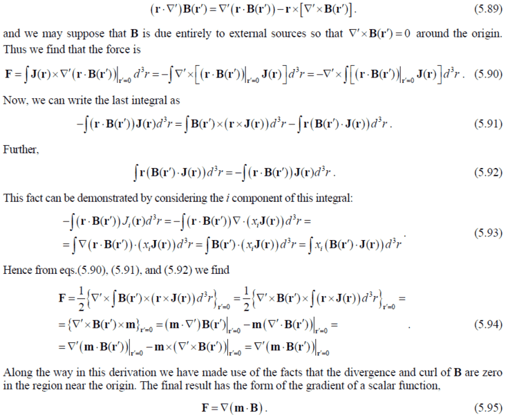

ok this is not a homework but i am confused by the derivation of ## f = \nabla (m . B)##
both start out with ##\vec B(r) \approx \vec B_0 + (\vec r' . \nabla)\vec B|_0 ... \\
f = \iiint_{v'} \vec J( r') \times (\vec r' . \nabla)\vec B|_0
where prime is body coordinates and unprime is space coordinates
the first one uses vector identities
(\vec r' . \nabla)\vec B = \nabla (\vec r' . B) - r' \times (\nabla \times B)
the other two terms die out because of different coordinates
then it proceeds to say curl of magnetic field is zero about the origin if it is due to external sources
then the proof proceeds i have posted in the photo
the second proof(from girffiths) uses le cevitas and kronecker deltas
while both seem to arrive at the same answer of ## f = \nabla(\vec m . B)## after this griffiths specifically mentions that
he mentions that ##\nabla \times B \neq 0##
honestly to me the first proof makes more sense because the magnetic field used is due to external sources and should not have curl at the origin but questioning seems griffiths seems inplausible so
what actually is correct sorry for the long post it has been bugging me for a long while now

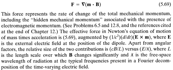

Both proofs end up with ##\vec F = \vec \nabla (\vec m \cdot \vec B )##. The first proof assumed ##\vec \nabla \times \vec B = 0## at the location of the dipole while Griffiths' proof did not assume this. So, Griffiths has shown that the result holds even if the dipole is located at a point where the external field does not satisfy ##\vec \nabla \times \vec B = 0##.
Griffiths gives a specific example where ##\vec \nabla \times \vec B \neq 0## at the location of the dipole ##\vec m##. This is problem 6.5 in the 3rd edition of the text. The dipole is immersed in a block of material for which there is a uniform current density ##\vec J## in the material. This current density produces the “external” field felt by the dipole. So, in this case, ##\vec \nabla \times \vec B \neq 0## at the location of the dipole. Instead, ##\vec \nabla \times \vec B = \mu_0 \vec J## . But Griffiths' proof is still applicable to this situation. So you can still conclude that for this example you would have ##\vec F = \vec \nabla (\vec m \cdot \vec B)##.
You quote Griffiths as follows
To understand this, you need to see the full context.
This is related to part (c) of problem 6.5, which states
“In the electrostatic case the expressions ##\vec F = \vec \nabla (\vec p \cdot \vec E)## and ##\vec F = (\vec p \cdot \vec \nabla ) \vec E## are equivalent (prove it), but this is not the case for the magnetic analogs (explain why).”
Griffiths’ solution for this part contains the following,
[The very last line in this quote applies to the specifics of parts (a) and (b) of problem 6.5.]

Yes, I believe so. Look at the following
The term underlined in red in (5.89) will not be zero if the curl of B is nonzero. This will lead to an extra term in 5.90 which can be shown (using various manipulations along with ##\vec \nabla \cdot \vec J = 0) ## to equal ##\vec m \times (\vec \nabla ' \times \vec B(\vec{r}') ##. But this is exactly what is needed to cancel the term underlined in blue in the last line of (5.94). So you still get ##\vec F = \vec \nabla ' \left( \vec m \cdot \vec B(\vec {r}') \right)|_{r' = 0} ## without having to assume the curl of B is zero.

The term underlined in red in post #4 leads to an extra contribution to the force ##\vec F## of equation (5.90) of the form
##\vec {F}_{\rm extra} = -\int \vec J(\vec r) \times \left[\vec r \times \left( \vec {\nabla}' \times \vec B(\vec r') \right) \bigg|_{r'=0} \right] d^3r##
For convenience, let ##\vec S \equiv \left( \vec {\nabla}' \times \vec B(\vec r') \right) \bigg|_{r'=0}##.
So, ##~~\vec {F}_{\rm extra} = -\int \vec J(\vec r) \times \left(\vec r \times \vec S \right) d^3r##
Use a vector identity to show
##\vec {F}_{\rm extra} = -\left[\int \vec J(\vec r) \cdot \vec r d^3r \right] \vec S + \int \left( \vec J(\vec r) \cdot \vec S\right) \vec r d^3r##
EDIT: The signs of both terms on the right are wrong. It should read ##\vec {F}_{\rm extra} = \left[\int \vec J(\vec r) \cdot \vec r d^3r \right] \vec S - \int \left( \vec J(\vec r) \cdot \vec S\right) \vec r d^3r##
The integral in the first term on the right can be shown to be zero. In order not to lose the train of thought, we can come back later to prove it. So, accepting it for now, we have
##\vec {F}_{\rm extra} = \int \left( \vec J(\vec r) \cdot \vec S\right) \vec r d^3r##
You want to show that this will cancel the term underlined in blue in (5.94) of post #4. That is, you need to show that
##\vec m \times \left( \vec {\nabla}' \times \vec B(\vec r') \right) \bigg|_{r'=0} = \int \left( \vec J(\vec r) \cdot \vec S\right) \vec r d^3r ##
Recalling the definition of ##\vec S##, you need to show
##\vec m \times \vec S = \int \left( \vec J(\vec r) \cdot \vec S\right) \vec r d^3r ##
This requires some additional manipulations and use of the identity given in equation (5.92) except with ##\vec B(\vec r')## in (5.92) replaced by ##\vec S## .

I believe B is the field due to external sources. B is not the field produced by the currents of the magnetic dipole itself. Jackson gives a derivation of ##\vec F = \vec {\nabla} (\vec m \cdot \vec B)## where ##\vec m## is due to a localized distribution of current ##\vec J## and it is assumed that the current density of the magnetic dipole obeys ##\vec {\nabla} \times \vec J = 0## [Edit: This should be ##\vec {\nabla} \cdot \vec J = 0##] . In the second edition of his text, Jackson states that the result of the derivation "holds even for time-varying external fields." I interpreted this to mean that the external B could be time-dependent. A time-dependent B is always accompanied by an electric field E obeying ##\vec {\nabla} \times \vec E = - \frac{\partial{\vec B}}{\partial t}##. In general, ##\vec E## could be time-dependent, too.
However, I later looked at Jackson's 3rd edition. He gives the same derivation of ##\vec F = \vec {\nabla} (\vec m \cdot \vec B)##, but he drops the remark that I quoted above. Instead, he adds the following comments which I find confusing:
I then decided to browse through the American Journal of Physics for articles related to this. I found a number of articles which I only skimmed through. This is when I decided that when there are time-dependent external fields, there are subtleties to this topic that would require quite a bit of time to sort out (for me, anyway).

Integrate both sides over all space and use the divergence theorem to show that the integral of the left side is zero.
So, ##\int x_i J_i(\vec r) d^3r = 0## for each ##i = 1, 2, 3##.
Therefore, ##0 = \sum \limits_{i = 1}^3 \int x_i J_i(\vec r) d^3r = \int \vec r \cdot \vec J(\vec r) d^3r## .
wait nevermind ignore my last post i got confused
TSny said:
∇⋅(x2i→J(→r))=→J(→r)⋅→∇(x2i)+x2i→∇⋅→J=→J(→r)⋅→∇(x2i)=2xiJi(→r)( no sum over i)∇→⋅(xi2J→(r→))=J→(r→)⋅∇→(xi2)+xi2∇→⋅J→=J→(r→)⋅∇→(xi2)=2xiJi(r→)( no sum over i)\vec \nabla \cdot \left( x_i^2 \vec J(\vec r) \right) = \vec J(\vec r) \cdot \vec \nabla(x_i^2) + x_i^2 \vec \nabla \cdot \vec J = \vec J(\vec r) \cdot \vec \nabla(x_i^2) = 2 x_i J_i(\vec r) \,\,\,\,\,\,\, (\text{ no sum over i})
oh wow that's very smart i was trying to look for something along that line i believe
\int J d^3r = 0
is proved in a similar way
thanks for the help i have a side question
is this
\vec c \cdot (\nabla \vec d)
same as
(\vec c \cdot \nabla) \vec d
from what i understand gradient of vectors gives tensors
\int J d^3r = 0
Yes. I had seen this way of proving ##\int \vec J d^3r = 0##, which helped in constructing the proof of ##\int \vec r \cdot \vec J d^3r=0##.
is this
same as
Yes, if you interpret the notation ##\nabla \vec d## as a dyadic quantity, then I believe the two expressions are the same. A dyadic is a tensor quantity. See https://en.wikipedia.org/wiki/Dyadics
More specifically, see the first box shown here https://en.wikipedia.org/wiki/Dyadics#Product_of_dyadic_and_vector
thanks one last question
in geometric calculus (have no idea what it is) i saw gradient of a vector function f defined as
divergence of f plus the curl(or something like that) f
why is there such a definition it does not make sense dimensionally the first is a scalar and the second is i am guessing higher order than vector
and is this somehow just a different representation of dyadic gradient
I have never learned geometric algebra and geometric calculus, so I can't be of any help here. In the "geometric product" of two vectors, you get two terms: an inner product term and an outer (exterior) product term. I don't think that either term would be directly related to the dyadic formed from the two vectors. But I could be wrong.
