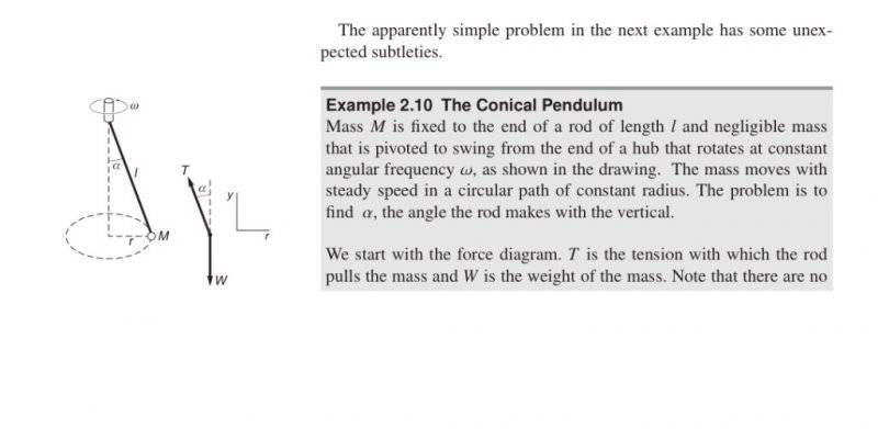

In the book "Introduction to Mechanics" by K&K, in the section on conical pendulums, the net force in the ##\hat{k}## direction is set to zero, since the ##z##-coordinate of the particle doesn't change. However, later on the effect of changing ##\omega## on ##\alpha## (the angle the rod makes with the vertical) is discussed. If we change ##\alpha## according to the equation we obtained by applying Newton's second law in the ##\hat{r}## and ##\hat{k}## directions, then ##\ddot{z}## is most probably no longer zero, which contradicts the equation we used earlier. How are we allowed to change ##\omega## if it gets in the way of some of the assumptions we made earlier (such as ##\ddot{z} = 0##)? Or does the author mean comparing two different systems with different values of ##\omega##, but not actually changing the value of ##\omega## for a particular system? What am I missing here?
Is the text assuming steady state at a fixed angle - which you may change to a new angle?
Then the formula may not apply while the angle is changing, only while the angle is not changing.

Nothing in the attached files to contradict what I wrote in post #2.
The problem statement says that the motion is at a constant radius.
