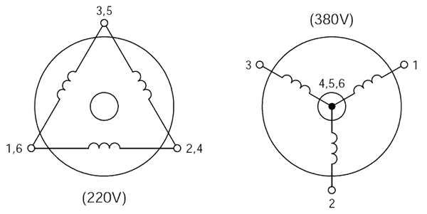

It means that the output has 415V phase to phase (delta connected) and 240V phase to neutral (wye or star connected).
Graham are you sure about that?
Since 415 is 240√3, i'd assume that his generator has three 240 volt windings which,
when connected delta,
give 240 volts phase to phase with no neutral
and when connected wye,
give 415 volts phase to phase and 240 phase to neutral.
image (courtesy of anaheim automation, via google images ) for a 220/380 machine,
... same √3 relation as 240/415 to nearest volt.
this website claims his brand of generator has twelve wire connections
https://www.cumminsgeneratortechnologies.com/en/products/stamford/uc/uc27/
•Windings offered are 12-wire reconnectable (for single or three phase)
which suggests that each winding is actually two half voltage windings , allowing 120/208 voltage too.
perhaps op can post a photo of nameplate or page from his manual...?

Ah yes. I was considering the load point of view but, yes, if the generator wiring gives that flexibility your proposal is good too. Thanks for the extra information.
The ratings book here gives more details of the wiring options:
https://www.cumminsgeneratortechnologies.com/www/en/download/ratingsbook/RatingsBook.pdf
The op needs to check the data sheets for the specific model number of his generator to check which wiring options are possible on his generator - I got the impression that you can't have every option on every generator but it's tricky to check without a generator to look at.
And again the op needs to check with his electrician that 240V phase to phase operation is acceptable for his local installation code.
