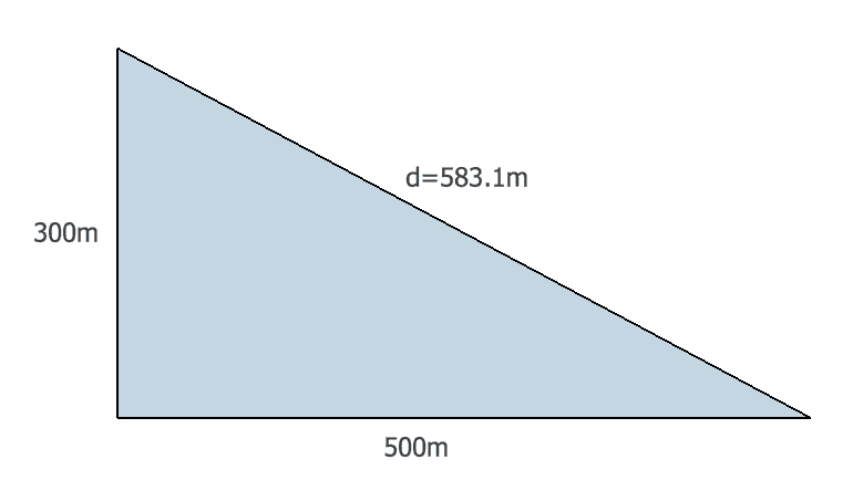

During a rockslide, a 710 kg rock slides from rest down a hillside that is 500 m long and 300 m high. The coefficient of kinetic friction between the rock and the hill surface is 0.23.

a)[/B] Easy. Uο=(710)(9.8)(300)=2087400 J (Accepted as correct answer)
b) θ=tan-1(300/500)=31°
N=(710)(9.8)cos(31)=5964.2 N
Fƒ=(.23)(5964.2)=1371.8 N
Wƒ=(1371.8)(583.1)cos(180°)=-799896.6 J (This was not accepted as correct answer)
(c)
Uο+Kο=Uf+Kf+Wƒ
2087400+0=0+Kf+799896.6
Kf=1287503.4 J (Also not accepted as correct answer)Please let me know where I went wrong.
Where did the 583.1 come from?
Should the answer be positive or negative?
583.1 is the distance the rock slides found by the Pythagorean Theorem √3002+5002. I tried both positive and negative with those answers. I assume the work done by friction is always negative since it is opposite the motion. and the kinetic energy should be positive because the velocity would be in the positive x-direction.
You misinterpreted the problem. The 500 is the hypotenuse.
Chet
Chet
... which means this is also wrong:
θ=tan-1(300/500)​
Chet
Ahh knew I missed something basic. Thanks a lot.
