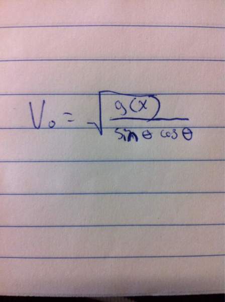

I used the equation
. I used this to try to find the initial velocity and then used the initial velocity to try to find the kinetic energy when the potential energy is zero thus finding the energy needed for the system. I got the wrong answer. Is the formula I derived not correct?
X represents the x distance at the top of the projectiles motion.
Equation for trajectory:
$$X = \frac{V_{0}^2\sin(2\theta)}{g}$$
I think they want you to assume your angle ##\theta## is 45 degrees, because that is the angle at which a maximum trajectory will occur.
You are given the trajectories but not the initial velocity, so that is what you want to solve the above equation for.
After that, I am going to assume you know the equations for work and energy. Since they are asking for the average force over a given distance, the standard ##W = Fd## equation can be used.
The way you wrote that equation is unclear. Could you send me a better representation?
Umm, not sure how else to write it. If you were to read it out, you'd say that the trajectory of a projectile is equal to the initial velocity squared multiplied by the sine of 2 times the launch angle theta, divided by g, the acceleration of gravity.
##X## = trajectory
##V_{0}## = initial launch velocity
##\theta## = initial launch angle
##g## = acceleration of gravity
Ok I get it. Thanks!
