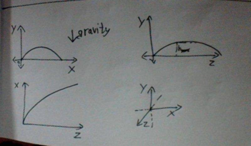

Maybe you could consider the trajectory situation in the presence of wind ➡ in the direction parallel to the ground and perpendicular to the original path of the trajectory!

The particle would deviate from its original trajectory along a curve and the motion would no longer occur in a single plane?
Exactly, it would look like a normal trajectory when viewed from the zy plane and xy plane. hence you need a 3D representation!
But would the acceleration still be constant (in both magnitude and direction) in such a situation?

I didn't say air drag, i said wind in the horizontal direction perpendicular to the path of a normal trajectory! wouldn't that be in 3D?(OP's original question)?
The point is that with any constant wind flow, regardless of direction, a resultant acceleration vector can be found out (resultant of the acceleration due to wind flow and due to gravity), and this would again result in motion that can be described in a single plane. There is no global coordinate system here, so you can just arbitrarily redefine your x and y axes to describe the motion in the xy plane.
I'm sorry Pwiz but I'm not able to imagine the 3D situation. This is my interpretation, its probably wrong, but what's wrong in it?Could you point it out?
That is because the situation cannot be said to be in 3D if you redefine your axes. Try imagining that the object makes a parabolic path between the x, y and z axes somewhere. Now what if you "rotated" your view so that the parabolic path faces you? Would the motion still be 3 dimensional?
