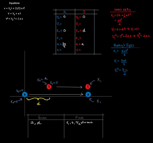

At the instant the traffic light turns greeen, Stan Speedy starts from rest and accelerates at "a". At the same instant Kathy Kool starts from rest "d" behind Stan and accelerates at "5/4a" (not sure, but I think this is meant to be (5/4)a or 5a/4, my attempts with "5/4a" gave me strange answers).

I've attached an image that shows a diagram I drew to help me solve the problem. Whether it be correct or not, that I do not know.

My reasoning for this was to then solve for t so that I would then know at what time that these two cars would be at the same point, and then I could use t to help me calculate the other unknowns, but whenever I try to solve for t, I get 0, which doesn't make much sense to me.
I think my problem is that I'm not accounting for the starting distance between Kathy's and Stan's car at the beginning of the problem.

Your picture is very nice and you correctly showed that Stan's initial position is X(0)=d if Kathy is at the origin initially, x(0)=0. Put this fact into the equation of Stan's position. The equation you cited is x=x(0) +v(0)t +(a/2)t^2.

*Face Palm*
After taking another look at the equation for Stan's position, I noticed the equation I wrote in my notes was x=v(0)t +(a/2)t^2, not x=x(0) +v(0)t +(a/2)t^2.
(you can even see it in my drawings in the time left corner)
After fixing that and following your suggestion, I was able to get some results that seem promising. Once I fix my notes, I'll try to run through this problem in its entirety and see if I'm successful.
Thanks a lot Ehild, I'm glad I decided to post this on the forums.
