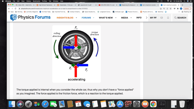

bob012345 said:
I did not make that diagram nor originally post it but I reposted it to argue I thought it was wrong. Here is another free-body diagram I found of a wheel slowing down by rolling resistance. It looks like it would have a torque that would speed the wheel up but we know it does not so there is something about the way friction works at the point of contact that I'm just not getting. It is easy to see how ##F_{rr}## will act to slow down the wheel but I don't see how the torque ##RF_{rr}## acts in the correct direction. I wonder if it has something to do with the point of contact actually being the center of rotation? And where is the static friction in this diagram? The brain fog continues...
https://www.physicsforums.com/attachments/296631
https://archive.thepocketlab.com/educators/lesson/rolling-resistance-physics-lab
The Post #85 diagram shows rolling resistance as a simple horizontal force acting at the base of the wheel, vertically below the wheel's centre. This is an inaccurate simplfication and (as has already been noted) gives a torque which would tend to accelerate the wheel!
A better representation is this: https://www.lockhaven.edu/~dsimanek/scenario/rollres3.gif
For this diagram and accompanying explanation, see the section entitled “Rolling Resistance” about halfway down this link: https://www.lockhaven.edu/~dsimanek/scenario/rolling.htm
  • #92
bob012345 said:
Ok, I resolved my brain fog issue over the free body diagram of the wheel alone. What bugged me in the diagram is that it looked like the blue Axle force to the right was exactly equal to the static friction force to the left which could not be true under acceleration. The total forces left and right are slightly different and total to a net force of the exact amount necessary to accelerate the wheel of mass ##m## by acceleration ##a##. Likewise the driving torque at the axle is greater than the counter torque due to all other torques by exactly the amount consistent with an angular acceleration ##\alpha= \large \frac{a}{R}##.View attachment 296601
The diagram is not a true free body diagram (FBD).
It's a simplified schematic version to explain the relationship between force and torque directions.
What is important to understand is that a rolling wheel can reverse the friction force direction by reversing the wheel torque, even if the rolling direction stays the same.
In an accurate FBD, yes, there would be wheel accelerations to consider (both linear and angular). BUT THIS IS IRRELEVANT TO THE PROBLEM AT HAND. It would only confuse the OP to make an FBD for each wheel and the car's body. Just imagine the wheel is massless and the car's body is heavier by the equivalent of the wheels' masses.
Rolling resistance should also be ignored for this discussion. IT IS IRRELEVANT TO THE PROBLEM AT HAND and can only confuse the OP.
