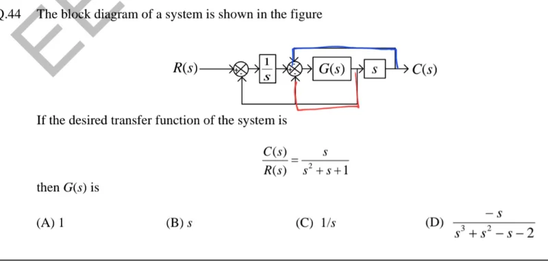

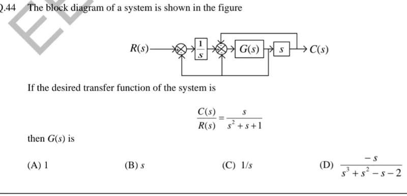

I have been helping a friend who is preparing for a national level EE exam. While going through the previous year question papers for this exam, he found this question.
Standard block diagram reduction techniques
I got the answer by simplifying the block diagram using standard block diagram reduction techniques and a bit of algebraic manipulation.
However, in the summing block between 1/s and G(s), they are subtracting both C(s) and C(s)/s at the same time (despite having different units)!
As per my understanding, addition/subtraction of two quantities is allowed only when their units are same. In the above diagram, C(s) and C(s)/s have different units and cannot be subtracted as shown in the diagram.
Am I missing something here or is the question actually incorrect?
Thanks in advance!

Baluncore said:
The graph shows a signal path, let's call it voltage, with processes acting on the signal voltage. Those processes are time delays and arithmetic, that probably result in negative feedback.
1/s represents an integrator in the Laplace domain.
Thanks for the response!
Suppose C(s) is a voltage signal.
In the diagram below, the blue feedback path directly goes to the summing block, indicating a voltage signal subtraction.
But the red feedback path also goes to the summing block and it is not a voltage signal (it is voltage* 1/s, or a flux signal more appropriately)
So this does not look like a valid block diagram to me.
You might think of this diagram as an ODE. There's nothing wrong with saying ##x(t) +\int{x(t)}\, dt ...## in that context.
1/s, or s-1 represents a pure integrator in the Laplace domain, it functions as a time delay or a low pass filter. It is not a 1/x reciprocal function.
Note that in practice you would have constant factors on each term that in principle convert to the "correct" unit, like for the often used PID control.
