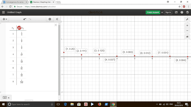

Here is a plot of the magnitudes of a few terms. Although what you said is true( every even term is smaller than the preceeding odd term), every odd term after an even term is larger. How can I tell now whether the series is convergent or divergent?
Try a comparison test. Can you think of a convergent series to compare it to? Group the odd-even terms in pairs.

However, if the original series were conditionally convergent, wouldn't grouping change the convergence as by grouping terms in different manners we could change the convergence of the series?
Also, why does the graph show that every even term has a greater(in magnitude) odd term succeeding it(in case the series is convergent)?
