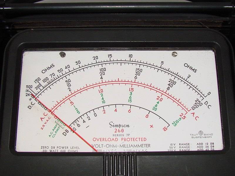

i posted this image in the other db thread
db scale on a voltmeter,
Simpson 260 is set up for telephone company standard 600 ohm, see lower left
it wouldn't be much use at rf but is fine for audio
db is bottom scale , just below red 2.5VAC scale
0dbm (edit-jh) = 1 milliwatt into 600 ohms observe they defined their reference there on the meter face

dBm has no units because it IS a unit. It like saying 5 inches and then asking what the units are for inches.
dB is like saying 3 inches is 2 times as long as 1.5 inch.
BTW. 0 dBm (not 0 dB) is 1mw into 600 ohms. 0 dB has no fixed reference level.
dBm is an absolute expression of power (as is dBu and dBW). dB is a ratio between two power quantities.
No. The impedance does not need to be specified for dBm. Only when you convert dBm to voltage or current must the impedance be specified.
It is probable that telephone and audio engineers will use 600 ohm systems while RF engineers will use 50 ohm systems.
The Simpson meter measures low frequency AC volts. It then calibrates the 2.5VAC voltage scale in dBm. It must therefore specify a reference impedance. Since it is a low frequency meter it uses the audio 600 ohm standard. Notice the table of additives in the lower right of the panel for use on different AC voltage ranges.
The 5000 ohms per volt spec on the 2.5VAC range offers an impedance of 12.5k ohm to the circuit.
For 600 ohm measurements you must sort out your own termination.
The thing that makes the Simpson meter an asset is not the dBm scale. It is the "Taut Band Suspension".
I agree with all that. I misspoke. The reference is 1 mW, pure and simple. I understand that the 600 ohms (or 50 ohms) only allows a voltage reference.
I did say "So you could say that 0 dBm is is 0 dB greater than 1mW into 600 ohms. (the 600 ohms pins down the voltage)."
