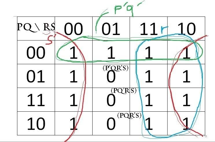

I think the easiest and most efficient way to solve this is to use a K-map especially in really long expressions.
lets name your function F
Computing for complement of F
F' = ((p+q’+r+s’) + (p’+q+r+s’)’ + (p’+q’+r+s’))'= (p'qr's)(pq'r's)(pqr's)
Then plot it on the K-MAP
(SEE BELOW)Then group the remaining ones (1s)
Which will yield:
F = s'+(p'q') + r.
Which is the same as the above expression.
