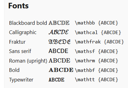

vanhees71 said:
Also note that units must be typeset in Roman (non-italic) symbols!
Interesting! I just used the default LaTeX font. How would I switch fonts in LaTeX? I'm off to the LaTeX Guide for some research...
Okay, I see how to switch to Roman, but don't see yet how to switch back to the default font...
##\mathrm cm^2##
You have to use \mathrm{m} to typeset the symbol for the unit meter within a formula: ##\mathrm{m}##. To get ##A=1 \mathrm{cm}^2## just type a=1 \mathrm{cm}^2.
