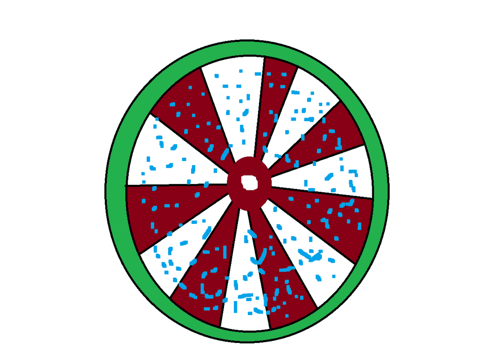

I have a question, see this is a slotted disc but the circumference is solid (shown by the green) the B field lines penetrate only the slotted part of the disc, (shown by the blue dots) if the flux does not go through the small circumferential solid circle only through the larger portion of the disc that is slotted would then there be circumferential currents in the circumference?
I ask this because it would make the disc structurally better if I could keep the disc solid at center and circumference and only make slots in the main part of the disc where the flux will pass through,
  • #58
artis said:
... if the flux does not go through the small circumferential solid circle only through the larger portion of the disc that is slotted would then there be circumferential currents in the circumference?
Yes, a circumferential current will flow whenever there is a change to the magnetic flux passing through the shorted turn.
