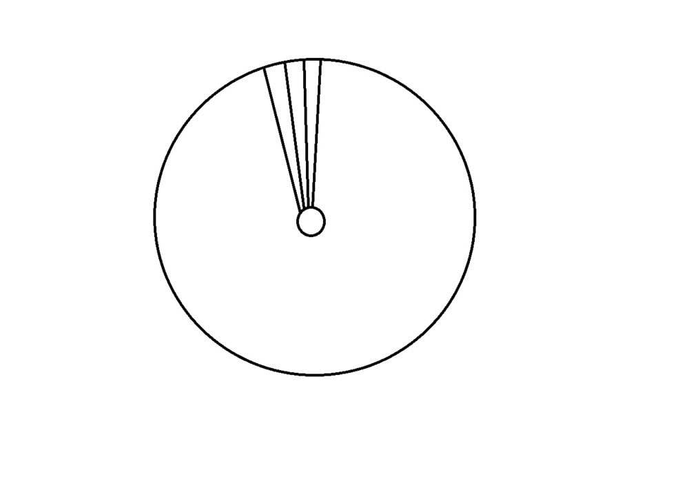

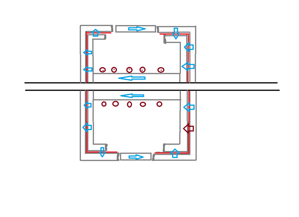

Hi, at this moment I'm trying to figure out one thing. I have a solenoid with a core that has an empty middle, the flux normally loops back around the outside of the solenoid to the other side where it enters back into the core. I need to route this field between the two ends of the solenoid core such that it passes through two gaps. I have made a crude paint drawing of how I would try to solve this can you please tell me whether my approach would work?
The field would be that of an 50/60hz AC current running in the solenoid coil , so a low frequency AC field.
There is one additional complication, ideally I would need the solenoid central endings to be joined by a material that has the same or close to the permeability of the solenoid core, but it's shape should cover the whole 360 degrees of a circle at the sides and a torus in the middle sections that close the flux path (seen in the picture as small grey rectangles) the torus part could be made from vertical stacked laminations but I can't figure out the side parts as they would need to be disc like but I cannot do it with laminations because each strip has the same width at both ends and so I would quickly run out of space near the center while there would be much empty space at the circumference.
Are there are large scale one piece (solid) materials that have the same or better characteristics than silicon steel or Metglas?
Not sure what characteristics you are referring to when asking for "better", as far as I know in terms of Bsat at least, there is nothing that can support more flux density before saturation than silicon steel, typically ~1.7T, compare to metglass ~0.6T.

I assume the hollow central core will saturate first. As the radius increases, so does the circumference. To maintain the same flux section, the saturation threshold of the material, and/or the thickness can be reduced. The outer cylindrical section can be quite thin.
I guess what you are saying is that because there is more material available for the same amount of flux the outer portions won't saturate first instead for a given field strength the inner solenoid core around which the coil is wound would saturate first?
Well I did not draw this picture with scale and proportions in mind but as you said I could make the outer laminations thinner gaining space there and using that space to expand and make the central core (the one around the axis) thicker, larger diameter so that more material is there so that overall there would be equal cross sections of flux path both in the center and the returning outer toroid sections.

I wonder how could such radially laminated disc performing if I added a solenoid type cylindrical core to the inner diameter of the disc would the flux flow freely from the cylindrical laminations into the radial ones as per the model that I drew in the first post.
Only difference is that in my case the radial laminations would have an extended L shape in order to guide the field back around.

Although simple but it won't cut my needs as I need a precise gap and everything would have to be sturdy enough to stand up to vibrations and other mechanical stresses.
Right now the best I can come up with is using laminations , for the central axis core simply use a rolled up sheet much like any toroid core uses just with a much smaller diameter and longer in length , aka a cylinder, then join the ends of such rolled cylinder with a disc at each end that consists of radial laminations (I'm seeing such are used in shunt reactor cores) only make the radial lamination to have an L shaped edge at the circumference where the field can turn 90 degrees in order to loop back as per my diagram

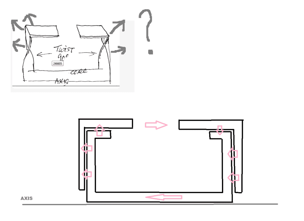

Also could you explain what you meant in the second part of your post #11?
@essenmein , but why couldn't the flux travel upwards the inner L and as it does so also leak over to the outer L continuously because the inner L's outermost section is shorter and only the outer L is connected magnetically for the field to travel and loop back so the flux would tend to go in the outer L.
The gap between the two L shaped discs would be no more than few mm thick and filled with copper conductor.

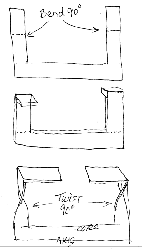

Start conceptually with a square bracket lamination. Bend the ends 90 deg. Twist the flat ends to point to the ends to the gap.
The thin laminations then sit close to each other in the core.
The width of laminations cover the outside diameter / circumference, and end at the gaps.
Together the twists in the legs nest together and look like a turbofan compressor from the end.

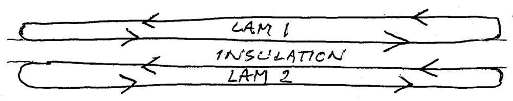

I believe you are disputing the requirement for ≈10% insulation thickness between laminations. So I will try to explain why such a wide layer is necessary between laminations.
Consider two adjacent laminations with insulation between them. Drawn in section, with the magnetic B field perpendicular to the page. Initially B passes through the insulation layer. As B diffuses into the surface boundary of the lamination, a peripheral current flows in the lamination surface. Notice that the current flows in the same sense in each lamination. Draw arrows on the periphery of both laminations to show current direction.
246608
Notice how the current on both the sides of the lamination, and on the sides of the insulation, flow in opposite directions. Notice that with the B field direction, the energy is moving with B into the laminations from the faces on both sides. After time for diffusion, the currents meet and cancel on the mid-plane of the lamination, where the B fields are parallel and in the same direction. Everything is good, so long as the energy has not diffused in too deep, and so cannot be recovered in time. That distance is related to the skin depth in the lamination material. The boundary that prevents loss of energy is where the two opposite current sheets cancel at the mid-plane. B cannot begin to enter and diffuse through the conductive lamination without the peripheral current.
As insulation thickness approaches zero, the two opposite surface currents approach coincidence and so cancel. That prevents the magnetic field entering the lamination. In effect the insulation is so thin it has choked the entry of B into the lamination material.

As for the twisting that you suggest , I now understand but doesn't that totally defeat my plan of having a uniform flux direction in the gaps at each side between the L shapes?
In my drawing I'm simply having two L shaped laminations stacked in a disc put on each side on a single central lamination that has L shaped sides but in theory could be cut out of single sheet as one piece but the idea is that the gap is always faced by the thin side of the lamination not the flat sheet side otherwise how would the flux (show by pink arrows this time) get through the gap from central lamination to the outer one?
