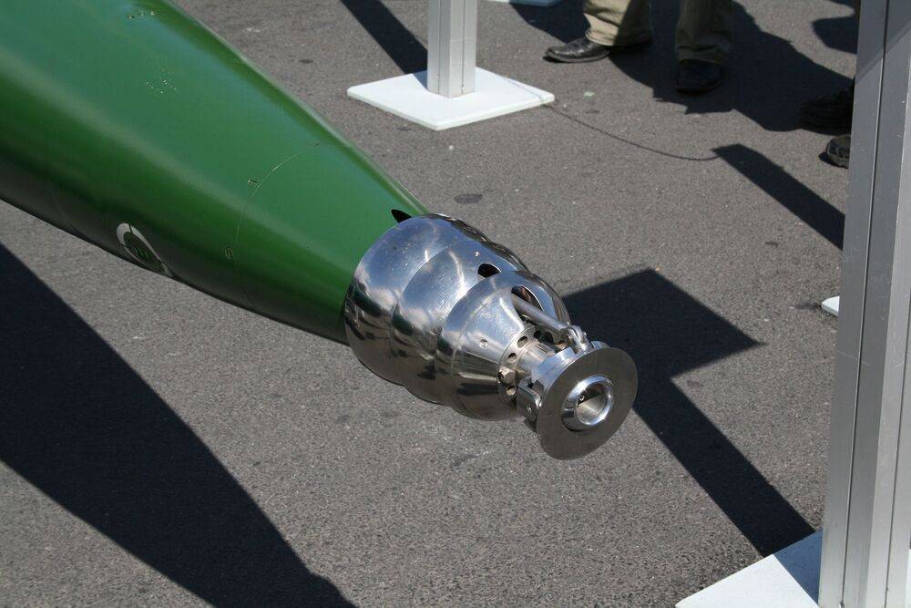

Flak as a countermeasure as been around since the beginning of aviation.
Modern Flak example:
