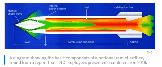

The issue with things like a nuclear interceptor is the altitude. The incoming threat is at a much lower altitude than an ICBM RV, so you'd be detonating nukes at a level that would pose serious risk to whatever is below. I once sat in a meeting where something like this was proposed and it was dismissed outright as unworkable.
Some version of flak may well be one of the options being developed. Details about hypersonic countermeasures are held even more closely than the offensive hypersonic systems currently under development.
Having said that, I'm skeptical that you could simply try to force something like this into a certain flight path filled with flak. They are more maneuverable than I think you're giving them credit for being. However, if you do manage to hit a maneuvering vehicle with a point defense, it makes the likelihood of an outright miss far greater than if it was flying directly at the target, so it's not all bad.

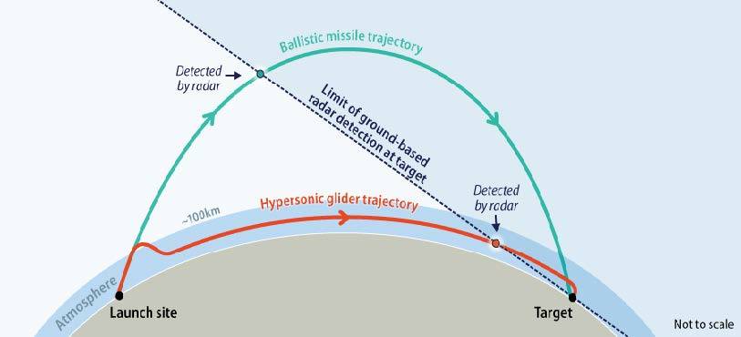

But that's just it; this is effectively the case with existing ICBM tech. That hasn't changed a whole lot in recent years and most countries invested in ABM systems have decided that interception in space is the highest-probability approach. If that fails, the RVs re-enter and have very limited maneuverability so there's a shot at hitting them with a terminal defense system like THAAD, Patriot, or Aegis. In effect, that Maginot line in space is what we have now.
The new breed of hypersonic missiles avoid those problems by simply not flying into space and remaining maneuverable up until the very end of the flight (a link back to the previous CRS report I cited). The figure from the CRS report pasted below is a good, simplified visual.
Figure 1 from the CRS report
Over time, I am confident all parties will concoct appropriate defensive measures, but substantial challenges remain. The original poster, @neanderthalphysics, correctly pointed out some of the major challenges associated with various methods that have been considered to defeat these weapons and was flamed out of his own thread for it for not already being an expert on the solutions (which, again, no one is).

I am a bit confused. The hypersonic tests that I've heard of fly these hypersonic devices in higher altitude thinner air. So with this hypermaneuverability hypersonic missiles will travel 50 feet above the ground like cruise missiles? Since the hypersonics are tested at high altitude, do we know what happens to a mach 6 hypersonic device hitting a rain squall? And active radar targeting that is unjammable?
It doesn't need to be sea-skimming at 50 feet to not be in space like an ICBM RV. One of these hypersonic missiles will be picked up on radar before something that flies extremely low like a Tomahawk would for sure. But a hypersonic system is moving so quickly that there is considerably less time to acquire, track and engage the target than with existing systems. They are also simply harder to hit because they are moving so quickly.
