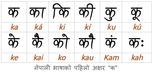

A Nepali consonant can take these many forms. "Ka" is first letter of Nepali consonant.
