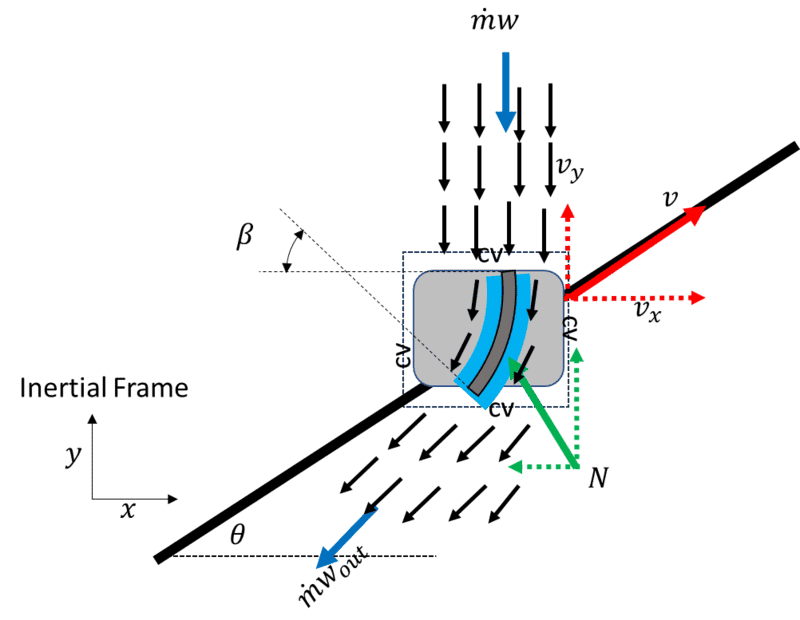

In the ground frame it's: $$\boldsymbol{w_{out}} =\left( v_x - \sqrt{(v_y+w)^2 + v_x^2 }\sin \beta \right) \boldsymbol{u_x} + \left( v_y - \sqrt{(v_y+w)^2 + v_x^2 } \cos \beta \right) \boldsymbol{u_y} $$
This seems to still assume fixed vane? For a aligned vane ##\beta## is the angle between ##\boldsymbol{u_{in}}## and ##\boldsymbol{u_{out}}##. Then ##\boldsymbol{w_{out}} = \boldsymbol{u_{out}} + \boldsymbol{v}##
A.T. said:
In my animation there is no vane, just a flat sail, which allows for elastic collision at different relative inflow directions, and thus different amounts of relative flow turning. A vane is a different model, because it fixes the relative flow turning angle.The true wind is always pointing down, but not the relative wind.OK
Why not call it ##u_{out}## to avoid confusion with the ground frame ?This seems to still assume fixed vane? For a aligned vane ##\beta## is the angle between ##\boldsymbol{u_{in}}## and ##\boldsymbol{u_{out}}##. Then ##\boldsymbol{w_{out}} = \boldsymbol{u_{out}} + \boldsymbol{v}##
The outflow always comes out of the control volume at a fixed angle ##\beta## relative to the control volume.
The flow field surrounding the control volume always looks something like this in the inertial frame.
You've made me "un black box" the control volume to explain the momentum exchange. It is not necessary to do so using Newton Laws.
erobz said:
The flow field surrounding the control volume always looks like this in the inertial frame.
The indicated flow directions are fine for the ground frame, not for the vane frame.
The indicated vane orientation is wrong, because it must be aligned with the flow relative to the vane, not relative to the ground.
Then don't unmask it. But then also don't define ##\beta## in terms of vane geometry. Define it in terms of relative flow turning, as the angle between ##\boldsymbol{u_{in}}## and ##\boldsymbol{u_{out}}##.
The indicated vane orientation is wrong, because it must be aligned with the flow relative to the vane, not relative to the ground.Then don't unmask it. But then also don't define ##\beta## in terms of vane geometry. Define it in terms of relative flow turning, as the angle between ##\boldsymbol{u_{in}}## and ##\boldsymbol{u_{out}}##.
There is something in the cv that makes the air come out of the box at a constant angle relative to the box. Are you telling me this is not allowed by the laws of physics?
What do you mean by that exactly? Between which two vectors is the angle constant? Specify the frame of reference for every frame dependent vector you are using to define the angle.
Between the wind in the ground frame and the outflow in the c.v. frame. Is there no possible entity inside the control which could make it true?
And why are you defining the angle ##\beta## based on velocities from two different frames?
Not a vane with fixed orientation and geometry. But if you allow those two parameters to change for different v (there is no reason why you shouldn't), then you can keep that ##\beta## you defined constant across different v. But it's not clear why you decided to keep it constant.
I also think that with this definition of ##\beta## your result from post #299 makes sense. For v -> inf the angle ##\beta## as you defined will be 45°. It's just a weird parameter, defined across different frames.
With the optimal vane orientation (bisecting apparent wind angle in the moving frame), the deflected wind is moving in opposite direction to the boat speed (parallel to the boat speed, but in opposite direction). The air leaving the control volume in direction opposite to the boat speed.
Assuming that the vane angle is adjusted to the optimal at any speed, that means that at any speed the air is deflected in direction opposite to the boat moving direction. And that is valid both in the ground frame and in the boat frame.
I still can't figure out what all the confusion is surrounding ##\beta##, perhaps I'm miss interpreting what it "looks like", but I think all of that not an issue. If the outflow is exiting at a constant angle ##\beta## (imagine there is a pipe sticking out of the control volume at angle ##\beta## relative to vertical in the diagram, it checks out; No bounds on velocity for some angle in this idealism. Any real body faces significant opposition to that proposition via drag. In theoretically idealistic cases I have to cast out my prior doubt of this.
You didn't specify the frame in which you measure the outflow direction. If the thing in your diagram is a pipe, then the outflow in the pipe-frame will indeed be ##\beta## relative to vertical. But in the ground-frame the outflow in will not will be ##\beta## relative to vertical (unless v = 0 or ##\beta## = 45°).
More importantly, the inflow side of you pipe is not aligned with the inflow in the pipe-frame (as it should be for efficient operation), instead it is aligned with the inflow in the ground-frame (which seems like an arbitrary choice that makes no sense).
Gleb1964 said:
One question, may be I missed before. Do you have control volume stationary at ground frame or it is moving with the carriage? If it is moving, the pipe sticking out moving volume would not blow the flow in direction of the pipe pointing.
I don't have it blowing the flow in the direction of the pipe in the inertial frame. This should be apparent from the mathematics surrounding the momentum transfers. The Reynolds Transport Theorem is valid in the inertial frame only. So every momentum flow is converted to the inertial frame in the equations.
For instance, I don't say the momentum outflow in the ##\boldsymbol{u_x}## is simply:
$$ - \dot m \sqrt{ ( w+y)^2 + v_x^2 }\sin \beta $$
I say it is in the inertial frame:
$$ \dot m \left( v_x - \sqrt{ ( w+y)^2 + v_x^2 }\sin \beta \right) $$
I'm not drawing the "true outflow flow momentum vector" in the inertial frame...It's just a diagram.
