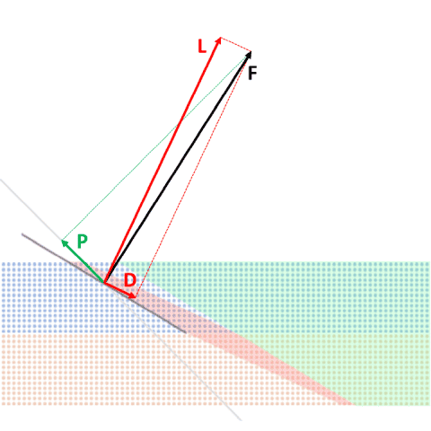

Here the speed limits plotted as function of the minimal apparent wind angle (AWA), normalized to multiples of true wind speed (TWS):
And here the speeds for AWA = 6° (ice boats) and AWA = 20° (racing boats), as function of the true wind angle (TWA), or the course relative to the true wind:
For the AWA = 20°, here the vectors for maximal speed:
Maximal downwind component:
Maximal upwind component:
The math:
LDair = lift/drag at the air
LDsurface = lift/drag at the surface
AWA : apparent wind angle
TWA : true wind angle
TWS : true wind speed
AWA = atan(1 / LDsurface) + atan(1 / LDair)
MAX_SPEED = TWS * 1 / sin(AWA)
MAX_DOWNWIND_COMPONENT = TWS * (1 / sin(AWA) + 1) / 2
MAX_UPWIND_COMPONENT = TWS * (1 / sin(AWA) - 1) / 2
SPEED = TWS * sin(TWA - AWA) / sin(AWA)

It's just basic geometry. Are you familiar with inscribed angles?
https://en.wikipedia.org/wiki/Inscribed_angle
The apparent wind angle (AWA) is the inscribed angle and determines the size of the polar circle, which constrains the velocity vector. The greater the lift/drag ratios, the smaller the AWA, and the larger the circle of possible velocities.
Just play around with this interactive diagram, move the sliders around and try different situations:
https://www.geogebra.org/m/tj5qf3w2

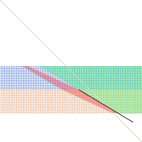

Here is an animation to visualize the kinematics with respect to the 2D air-mass, rather than a single jet.
The relative flow is along the bottom/left or top/right edge of the red area. And relative to the flow we have empirical data on lift(L)/drag(D) we can achieve. Shown below is a conservative L/D=8 which still results in the aerodynamics force (F) having a positive component along the direction of motion (P).
