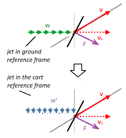

Gleb1964 said:
Here is your jet, as you wish. One in the ground frame and another in the cart frame. I have to split it in the volumes to illustrate somehow the transformation.
The jet CANNOT push the cart in the direction of the jet FASTER than the jet is going in the direction of the jet! No matter what you do to the sail orientation, or what angle you chose to go at relative to the incoming jet. Making anything you want variable... Momentum CANNOT enter ( nor exit) the cart at ##v_x = w##. The mass flow rate ##\dot m ## is a true "mathematical factor" in the sense that it is multiplied by anything you can come up with for the velocities- any configuration your heart desires. Short of DeVine intervention by the hand of GOD no matter what you do to the sail to maximize the acceleration of the cart there is a hard limit.
$$ \lim_{v_x \to v_j} \dot m = 0 \implies F_{nc} \to 0 $$
Period!

Here is the illustration, how slow wind (or jet) does collide with faster boat.

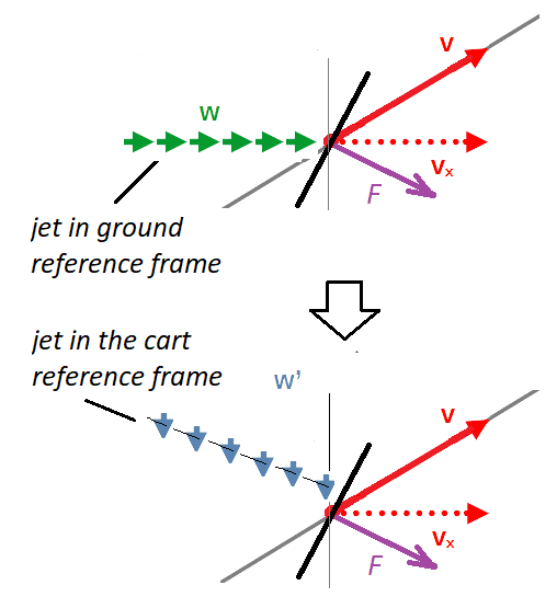

I don't think the orientation of the jet changes between the frames, just the velocity of the air particles, that the jet consists of.
The jet is animated here in different frames:

erobz said:
What you are proposing is not parallel to the agreed upon analysis technique shown in the video?
In your video the cart moves parallel to the jet, so even in the cart frame the incoming air in the jet still moves parallel to the jet.
But this is not the case if the cart moves diagonally, because here in the cart frame the air velocity is different from the jet orientation.
When you are trying to generalize from a simpler 1D-transformation (your video) to a more complex 2D-transformation, you have to be more careful.
A.T. said:
Ok, thank you for correction. You are right. I would need to think about it before posting.

erobz said:
I'm trying to find the velocity of the jet "##v_j## relative to the cart:
There are two relative velocities of jet, relative to cart and relative to the sail. Jet is crossing the planar sail, the velocity regarding to this crossing point is not the same, as velocity regarding to the cart.
