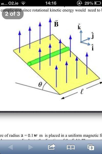

But, the -4.8i just acts into the plane, not parallel to it. The mgsin(theta) which I found is parallel to the plane, acting down it. I thought that the -4.8i was just the i component of the magnetic force. If that isn't the case though, then the magnitude is just |4.8i| and has no j component so therefore there won't be any magnetic force acting on the same plane as the mgsin(theta). Does that make sense?
Diagram of a green cylindrical rod lying across a yellow inclined plane tilted at angle θ, with blue vertical arrows labelled B representing a uniform magnetic field, length marked l, and unit vectors i, j, k shown at upper right.
That's the picture of the slope. See what I mean now?

If you take a look at the picture you can see that the -4.8i wouldn't actually be the hypotenuse, would it?

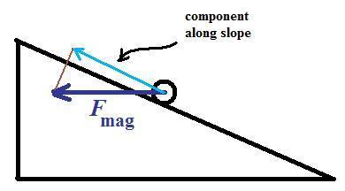

Yes. IL x B gives the total magnitude of the magnetic force (4.8 N). The 4.8 N acts horizontally in the negative x direction. You need to find the component of that horizontal force along the inclined surface.
So, just 4.8cos(theta)? I was drawing the 4.8 as the side opposite the right angle.
Yes. The 4.8 N is the hypotenuse (which is the side opposite the right angle.) See figure.
