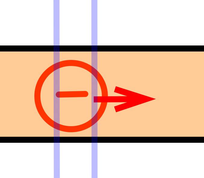

What if some particle of charge Q partially passes through a point in a wire as shown in the attached image?
Also does the particle have to reach the point at which current is being measure or pass it?
This is a nonsense idea. Without a doubt. It has nothing to do with Ohm’s law. Your attempt at extending a law which actually depends on a Quantum Effect has no validity at all. The valid intermediate models that bridge the gap between Electrical batteries and meters and QED do not include visible sized particles.
Should current not ever be thought of as charged particles passing a point in some unit time, and does the idea of current apply exclusively to continuous charge distributions?
Please note that in many particle accelerators, the charges come in bunches and not a continuous flow. In such cases, we have "average currents" and "peak currents", which designate some value over a period of time. There's no ambiguity here on what is meant by the term "current" in such cases.
BTW, the title of this thread is a bit misleading. By invoking "Ohm's law", you have made implicit assumptions on various things (for example, the parameters described in the Drude model). So trying to marry this with such discrete and discontinuous charge flow doesn't make sense.
