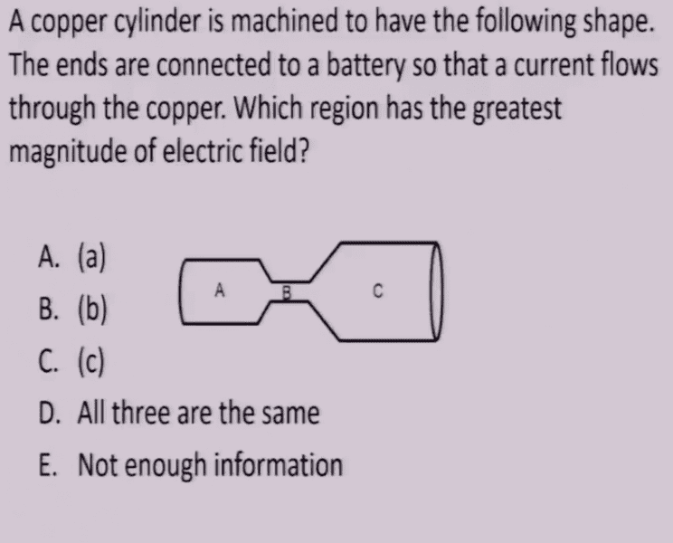

I = nqVA
J = E/ρ
J = I/A
The underlying assumption was that current was constant across all 3 bits of the conductor, and thus answer is b.
The concept I can't grasp is this: Why is current constant? Shouldn't a smaller A mean smaller current as well?
Is there a 'force' shoving more q through a smaller A to compensate and is there a mathematical way to show that current is indeed independent of area?
Help is greatly appreciated!

Consider Kirchhoff's Current Law.
Im not sure how to apply it in this scenario, my concept of it is that it applies to junctions?
Yes. The machined cylinder might be roughly modeled as having three distinct regions with their own resistance. Draw the equivalent circuit.
Apologies for not drawing the circuit as I'm hanging about outside. However if i were to draw it, i'd draw 3 distinct resistors connected via a wire in a series connection. Is this right?
If so, how does Kirchoff's Law apply? It says in my text that a junction has to be a connecting point between > 3 separate conductors.

It is series circuit I1 =I2=I3 =I
(R1+R2+R3) I =V
You might consider with one branch
Sorry, you might consider this a junction with one branch only

I suppose they must have some reason for defining a junction in that manner, but it doesn't matter. How do they define a node?
Node is a point where the incoming and outgoing currents are equal
That's a pretty unhelpful definition as it presumes KCL holds before proving it. Everywhere else I've seen a node defined it's a point where two or more components connect.
Regardless, you can assume that KCL applies to every point in a circuit, including anywhere along a conducting path.

Yes. If you think about it you can take any conductor and split it in two and you end up with two "components", one on either side of the split. So KCL applies there.
One component to note which appears to contradict KCL is the capacitor which consists of plates with a non-conducting gap between them through which charge carriers cannot flow. We know that charge builds up on a capacitor plate, so current-in doesn't equal current-out at that point. However, taking the capacitor as whole, an equal current leaves the opposite plate so that overall the current-in equals the current out, satisfying KCL for the component.
