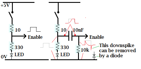

Here's my circuit. Left is the original, right with capacitor. ( Ignore the 10Ω resistor, that's just my quirk!)
In the original, when the switch is closed, the middle wire goes up to 5V and stays there until the switch is released, when it falls back to zero.
The same happens in the new circuit. The capacitor starts uncharged, so the full 5V is applied across the 10k resistor, but as it charges up, more volyage is across the capacitor and less across the resistor. When the capacitor is fully charged, 5V across it, there is no voltage left across the 10k. So the output is an initial 5V spike falling quickly to zero.
When the switch is released and the left side of the capacitor falls towards zero, the 5V across the capacitor drives current back through the LED and the 330 and 10k resistors, causing a negative spike on the output.. This is normally bypassed by a diode across the 10k, so that it does not affect the output. But this inverse "mini pulse" is in the wrong direction to enable the latch, so the latch won't get enabled twice per clock pulse. (But, I'd remove it, because the negative pulse could damage the chip and also cause undefined behaviour. I think some families of gates like 4000 CMOS have built in protection diodes.)

By stating that the "'mini pulse' is in the wrong direction enable the latch," do you mean that the electrons will not choose to flow through the "AND" gates in order to reach ground, since they prefer the routes RA and RB provide. Also, after the electrons discharge through 330/RA, won't that cause the LED to light up for a brief moment?

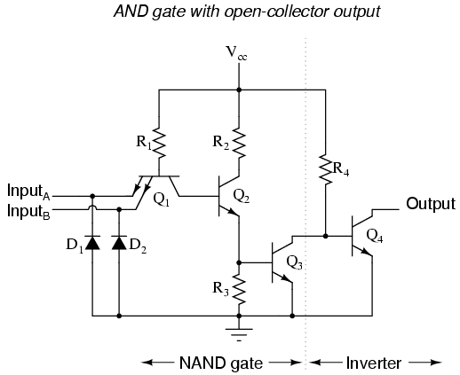

Looking at Q1, the input circuit: When a high voltage (+5V) is applied to both inputs, the transistor is cut off, because both emitters are reverse biased.
When either input is low, Q1 is switched on because the emitter is forward biased.
If an input is below zero (negative) then Q1 will still be switched on because the emitter is forward biased. D1/2 are just added for protection, because a negative input could draw too much current.
The rest of the circuit (which varies) is just to convert the output of Q1 to the required high or low and to provide enough output current to drive more gates.
Diode D1 or D2 will be reverse-biased on a high input and have no voltage across it on a low input, and therefore not conduct any current. The purpose for having D1/2 in the circuit is to prevent transistor damage in the case of a negative voltage being impressed on the input (a voltage that is negative, rather than positive, with respect to ground).
Edit: Oh yes, the discharge of C will provide a momentary drive for the LED. You won't see it though. The LED is on via the switch and C discharging just keeps the current going for a fraction of a second after the switch is flipped. So it just merges into the normal LED on period: instead of switching off sharply, it fades gently (over a few microseconds, so you won't notice even that !)
