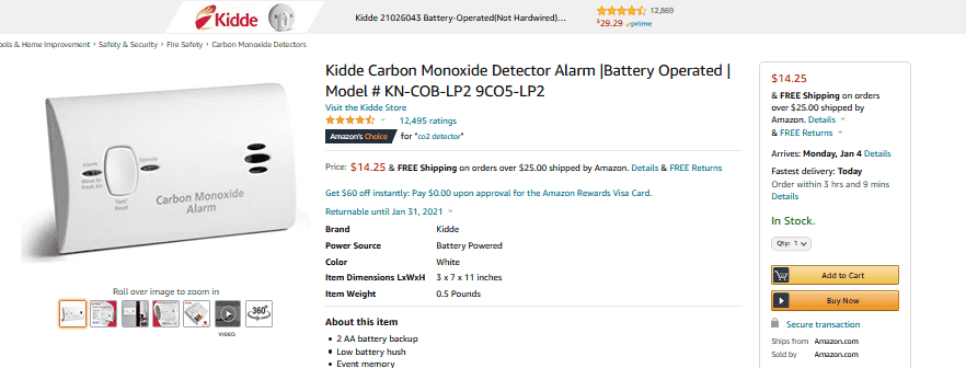

If you are concerned and have the freedom to pick which way you point your car when parking it, face into the wind. Also, consider getting a battery powered CO detector to put in your car's cabin. That will at least alert you if there starts to be a build up.
https://www.amazon.com/dp/B004Y6V6K4/?tag=pfamazon01-20
