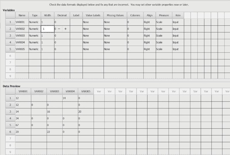

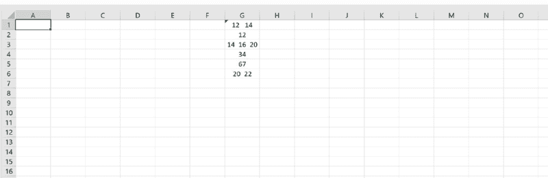

Find below a sample of the data that i want to import onto spss; My intention is to have the data appearing as one variable only on PSPP.
This is how it appears on PSPP;
It defaults as 5 variables, ...i used comma delimited and i am aware that the pspp regards any comma/space as a variable i.e if you were to have for instance;{20 30 90} on one excel cell then importing this to pspp( using comma delimited ), yields 5 variables on pspp...which is not exactly what i want. I want the data on Ms excel to be imported onto spss as one variable only.

I have the raw data on an excel sheet and i need to import to pspp...i am converting using the csv format. The data is too large to be uploaded here. Kindly note that i was able to import the data and subsequently analysed the data. The only issue was as indicated on post 1. I have data appearing as indicated on excel sheet ...
check column G for e.g Row 1 has two entries { 12 & 14} as shown...on importing to pspp...it defaults as two variables [i.e variable 1 and variable 4 as shown on pspp] ...i want this to appear\default as one variable only hence the reason why i posted this query. I hope this helps ...
How did it get there? If you are generating it with formulae, just use different formulae. If you have uploaded it from a CSV file it would be easier to work with the original CSV file. If you have been sent the file as an xlsx file then it would probably best to save it as a CSV file. You can then use any decent text editor (e.g. Visual Studio Code) to replace all " " (space) characters with "\n\r" (otherwise known as CRLF). Or write a Python, Perl etc. script to do this.
