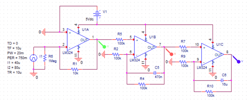

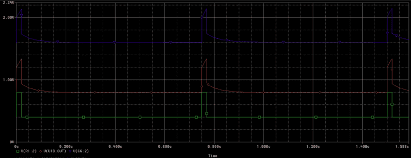

I am modelling a photodiode circuit which produces a small and periodic pulse with a small but potentially variable offset current. My circuit consists of a transimpedance amplifier to convert the small current into a voltage signal. The voltage signal is then filtered by a low pass filter. I wish to remove the small DC offset voltage but I cannot use a subtractor since the DC level may change.
My solution was to place a capacitor at the input of the low pass filter to remove the offset but allow any time-varying signals to be further filtered and amplified by the second stage.
As you can see from my PSPICE simulation, the voltage after the capacitor is only slightly reduced and the DC level is not 0V. The output of my second stage has also satured for some reason.
Some help would be very appreciated!
The + input to U1B needs DC bias. You can't just have a DC open circuit like that at most opamp inputs...

Thanks berkeman, I suspect this is to do with increasing the width of the depletion region in the diode? Unfortunately I don't have a negative rail available in my design.
Regarding your first response, I'm not sure exactly what you mean by this. Through experiment I have discovered that a resistor in parallel with U1B-IN corrects the issue but I don't really want to affect low frequency gain. My circuit needs to operate between 0 and 3 Hz.

The width of the region increases, which lowers the capacitance, which increases the bandwidth. But from your 3Hz operating frequency, it sounds like the 0V reverse bias may work.
Nice reference on photodiodes: http://www.osioptoelectronics.com/application-notes/an-photodiode-parameters-characteristics.pdf
Yep :smile:
Then you will likely need to do some other kind of circuit for the HPF ("DC blocking" function). I'd look at adding an active filter stage before the output stage maybe. Be sure to look at all of the sources of offsets -- you will get both input Vos and Ios with the LM324 series of opamps.

I've had a go at the averaging filter (see attached). For some reason the DC level is increasing through each stage (even with unity gain). Until I fix this I doubt the comparator will work. Could you take a look and let me know what improvements I can make?
Thanks again
Thanks again
View attachment 219620 View attachment 219621
What is the gain equation for a non-inverting opamp circuit? It's pretty hard to get a gain of 1 through a non-inverting opamp stage, unless it's just a follower with no other functionality... :smile:

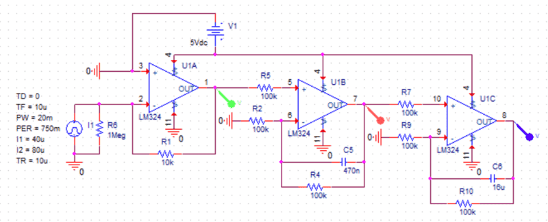

Although now I have a bit of a problem. For the circuit to work I need to go below 0V and I only have a single rail, 5V supply. Without splitting up the rail into +/- 2.5V is there anything else I might be able to do?
Thanks again
Are you talking about needing a negative rail to supply the 3 OP-AMPs?
Although the LM324 can work with just a single 5V rail, that is really not much headroom to have for most analog processing applications. It's better to run it from at least a 12V rail, and as you have found out, it's nice to have a negative rail for many opamp applications.
If you have enough headroom, you can impose an offset on the input signal, and then process the signal around that offset voltage at each stage. I'll upload a simple circuit that I have used recently to offset a signal that originates near ground, and I needed to do a bit of conditioning before routing it into a single-ended ADC. The power supply for the LM324 opamps in this circuit is only 3.3V, BTW. The top opamp is generating a Vref voltage that the lower circuit is using to offset the ground-referenced input voltage (and reference it to that Vref).

Hi Nascent thanks for the comment. The answer is yes because I need the inverting amps to get unity gain which is required for my subtractor to work.
Thanks again berkeman. I only have a single 5V rail available for this design so I might need to split up into +3V/-2V for example just to allow the inverting amps to work. It wasn't really what I was aiming for but I can't think of another way of acheiving unity gain and therefore a working subtractor without the inverting stage. Also thanks for the example you have attached I may use a similar circuit to create a virtual ground for my circuit.
Another option would be to use a simple DC-DC inverter circuit to make a -5V rail for your circuit. You could use a National Instruments Simple Switcher IC and the inductor and diode and capacitor recommended in their Simple Switcher Design Calculator, for example. Also, since you don't need much power from your -5V rail, you could use a simple capacitive inverting charge pump IC to do it. Maybe have a look into those two options to see if they would work for you. :smile:

Here's a way to remove the drifting average from vin. It can give some gain, if needed. It might allow you to avoid the need for a negative supply.
