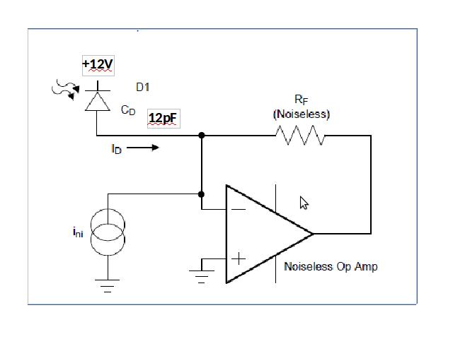

After some useful comments said here i just wanted to see this, how far i can go with a TIA
Let’s see what amount of noise i will have, with my requirements
Photo Diode is this Opamp is 6269-10
a Noise model of TIA
Calculating the Equivalent input noise of an opamp from the standard expression
Reference:surprisingly the application note tries to sense 10nA - 1uA using their TIA but i did not get how they are able to sense 10nA in their example at a BW of 80MHz,anyways we will come back to the calculation
The components being input spot noise, noise voltage term, thermal noise term, and capacitive noise term respectively
1. Current noise term : In = 7pA/rtHz
In @ 200MHz (even if rise time is 2ns(photodiode rise time) it corresponds to BW = 0.35/2ns which is 175Mhz, so let’s go by more +25MHz) = 7pA * sqrt(200M)= 98.9 nA = nearly 100nA
2. Voltage noise term : en = 5nV/rtHz
( i have seen a 1nV/rtHz fully differential opamp i don’t know whether it can be used for the purpose of TIA, experts have to suggest is it desirable to use http://cds.linear.com/docs/en/datasheet/6409fa.pdf but datasheet seems like i cannot go for high gains with this )
Voltage noise term = en/Rf
At 200MHz en = 70uV
Term becomes = 70uV / 20K =3.5 nA

4. Input capacitance term:
Important factor which has effect of increasing gain even
Input capacitance term = en* 2 * pi * f-3dB * Cin/rt(3)
En = 70uV
Cin= Cd(diode)+Cdif(opamp diff input)+Ccm(common mode inp)
= 12p + 0.1+0.45 =12.55pF
F-3dB = rt(4G/(2*pi*20K*12.55p)=50MHz
Total term = 70uV * 2* 3.14* 50M * 2.55p /(rt(3))=32359*1p=32nA
So the total input noise will be 132nA itself where as i am trying to sense 10nA :/
5. Now calculating high frequency noise gain,
NG = 20log (1+ (Cs/Cf)) = 20log (1+ (12.55p/100f)) = 42dB
NG = 125
So 132nA would become 132nA*20K*125 = 330mV which is horrible!(or did i do any blunder in calculation)
The signal which i can detect or measure would be at least 800mV-1V which is equivalent to input 50uA so this is my lowest limit , when going with a 5V supply i would saturate at 250uA only so my dynamic range is horrible to be ridiculed :(
Where i was aiming for 35dB at least
So if this is the situation i can simply avoid using a TIA and can go for using a resistor of 50ohm which gives me out a 1mV output voltage which i can keep as threshold and give the signal to a high speed comparator and do the digital conversion!
Why should i go for a TIA if i am not able to sense less than 20uA?
If there are any calculations mistakes please correct me in calculating the minimum current that can be sensed
The Data Sheet shows 7fA not 7pA.
in
Input Current Noise Density, VCM = 2.75V f = 100kHz 7 fA/√Hz
Input Current Noise Density, VCM= 4.0V f = 100kHz 7 fA/√Hz
Find Pg.8 and Pg.9 of the datasheet
only few datasheets show this, fortunately they have shown what happens at high frequency, iam operating at 10ns pulse which is 100M
OK, I had missed that. However that is wideband noise, how about following the first stage with a bandpass filter.

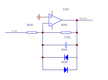

Your four stage amplifier looks fairly good other than the opamp saturation effects. You can add a pair of inverse-parallel diodes across the feedback resistors to avoid saturation. That of course limits the output voltage of each stage to 700mV. If you need more output, put some more diodes in series. That will also reduce their effective capacitance.

Your four stage amplifier looks fairly good other than the opamp saturation effects. You can add a pair of inverse-parallel diodes across the feedback resistors to avoid saturation. That of course limits the output voltage of each stage to 700mV. If you need more output, but some more diodes in series. That will also reduce their effective capacitance.
would you please show me how would you tackle this, please show as a schematic for better understanding to all users

The output pulsewidth is being stretched because the opamps are saturating at higher input levels and it takes time for them to recover, that's why I suggested adding diodes in my post #4. The added diodes would keep the opamps out of saturation.
yeah can you please suggest a mechanism in terms of schematic to protect the TIA input from excess current or in other way making TIA or opamp to avoid saturation
Note the Diodes in the feedback loop below, they clamp the gain to unity when the output tries to rise above their threshold voltage (about 0.6V).
Since you are using differential amplifiers, the diodes are needed in both fedback loops in a stage.
thanks for the diode based approach, i would try it, i have tried in LTspice which gave me oscillations from the opamp output, here i also want to know what are risks if i use a very low reference voltage of 1mV with my comparator, is that risky to with low reference voltage with comparators ?
Oscillations should not occur if the opamps you are using are stable down to unity gain. You can add a resistor between the diodes and the opamp input to adjust gain if needed for stability.
