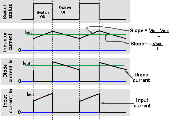

What effect does the inductance value have on the ripple in the output voltage?
The inductance value directly influences the output voltage ripple in power electronics. Higher inductance results in a smaller ripple, as indicated by the formula ΔIout=(Vin-Vout)⋅Ton/L. In continuous conduction mode, the relationship between inductance and ripple is governed by the inductor's ability to resist changes in current, described by the equation V=-L⋅di/dt. Understanding this relationship is crucial for optimizing power supply designs.
PREREQUISITESElectrical engineers, power electronics designers, and students studying circuit analysis will benefit from this discussion on inductance and output voltage ripple.
