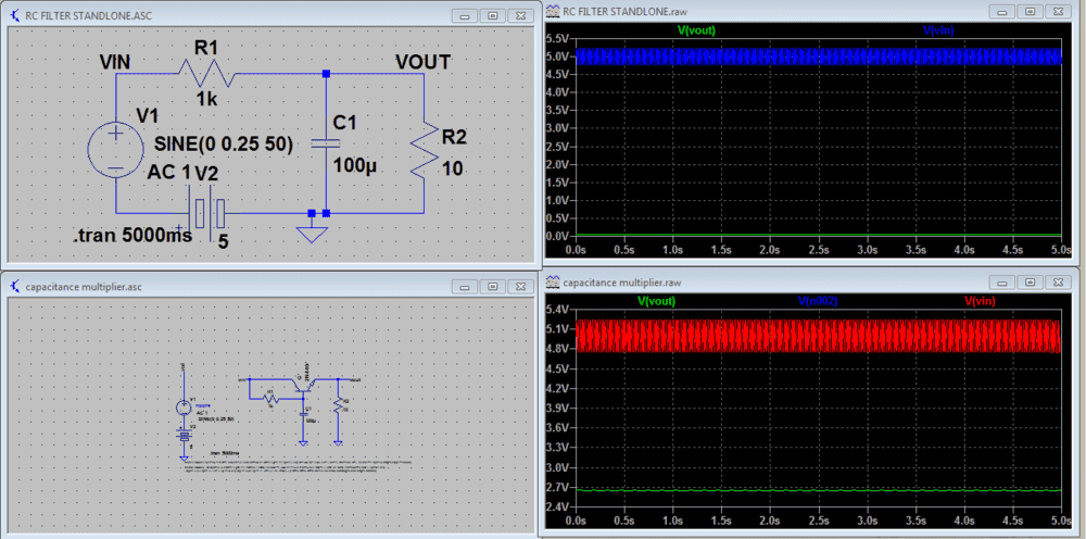

Dear friends,
I am simulating a capacitance multiplier circuit and an RC filter circuit simultaneously. My aim is to check the reduction in ripples when using a cap multiplier circuit against an RC filter.
I am familiar with ltspice but not quite an expert. I am comparing two output waveforms of both the circuits.
Can someone tell me how measure how much ripple has been reduced when cap multiplier is used. How to view that in simulation.??
.asc files have been attached below.
Two LTspice windows: left, schematics of an RC filter (R1 1k, C1 100µ, R2 10) and a capacitance multiplier; right, transient plots of V(vout) and V(vin) over 0 to 5 s, with ripple visible on the output traces.
Thank you!

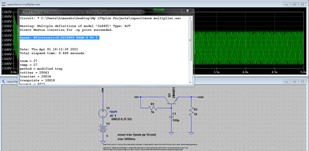

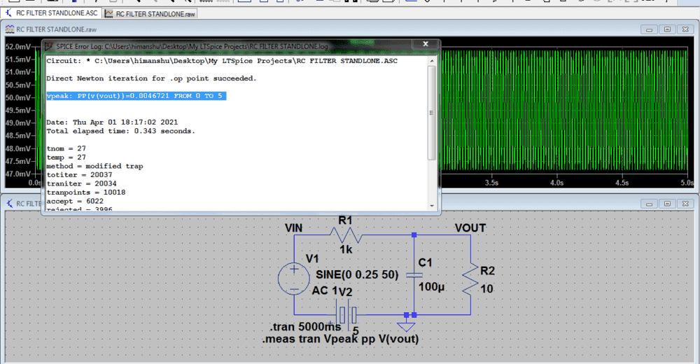

Probably I have done it.
I got some doubts too.
The peak to peak ripple voltage of RC filter came out to be 0.0046721 and capacitance multiplier is 0.215893 . This shows that ripple voltage of capacitance multiplier is higher than RC filter which make its purpose useless, as cap multiplier is used to suppress ripples.
What seems to be wrong here??

If you can compose an appropriate .MEAS script, LTspice will be more than capable of making the measurements. Alternatively you could use the mouse to zoom in on the plot and read out the differential ripple, or turn on the two differential cursors.
To compare two circuits, you might do better placing them on the same schematic.
The efficiency of your attenuator circuits is low. It doesn't appear that your circuits have yet matured to the point where accurate measurements are necessary.
It is not possible to identify or advise circuit changes if the circuit design requirements have not been specified.

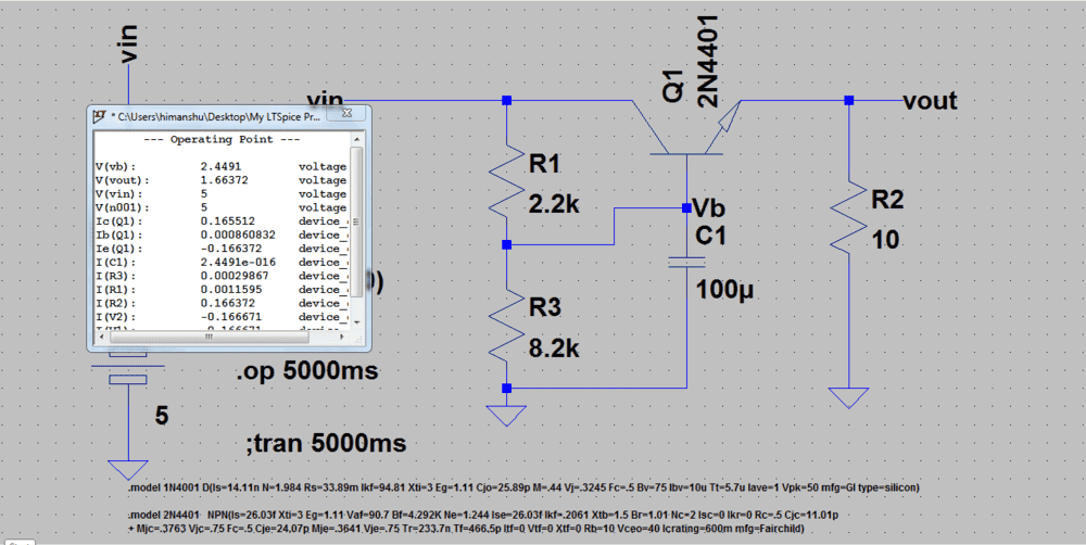

Joshy said:
you use it for biasing your transistor to ensure it's in saturation mode.
To bias a transistor either we can increase the base current or base voltage drive i.e more than 0.7 V. I tried with a parallel resistor and found that my base voltage is already above this value (2.44 V and 3.45 with single resistor).
I believe that this much voltage should be sufficient for driving the transistor into saturation??
LTspice schematic of an NPN transistor Q1 (2N4401) regulator with input vin = 5 V, R1 2.2k, R3 8.2k, R2 10, C1 100u, and output vout; an operating point text window is overlaid on the left.
LTspice schematic of a transistor circuit with Q1 (2N4401) biased through R1 (1k) from vin and C1 (100µ) at its base, output to vout across R2 (10), with an overlaid Operating Point results window listing node voltages and currents.
Joshy said:
I'm not familiar with this circuit although after browsing around I'm thinking you might be missing a resistor that should be in parallel with your capacitor; you use it for biasing your transistor to ensure it's in saturation mode.
The transistor should not be in saturation.
The lower resistor may not be needed, because it is replaced by the base current.

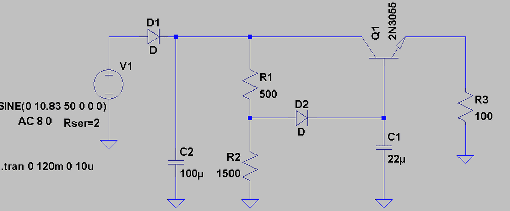

For those interested, here is an LTSpice simulation to play with. The AC Voltage source, Diode, and C1 capacitor replace the battery and pulse generator in @brainbaby's original circuit. This is to more closely emulate a transformer-rectifier-filter circuit.
The Voltage, frequency, and R1 R2 were chosen for 'easy' numbers to comprehend in the circuit. (10Vpk at Q1-C, 20mS per AC cycle, and a 3/4 (75%) divider for R1 R2)
Plot traces of interest are the Q1 terminals. The given values yield a 68% ripple across C2, and 28% ripple at the output.
Some things to experiment with: (individually, then in combination!)
Short D1
Change R1 value
Change C2 value
Remove R2
Change C1 value
Green plot trace is Q1-C.
Red trace is Q1-E (load, R3).

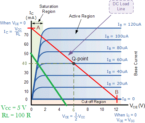

Assuming you're interested from a theoretical PoV rather than practical (when you'd better follow other people's advice), my observations:
The transistor does not look to be in saturation, because the Vce from the data printed at the side is
2.3 V or 3.3 V, both much more than I'd expect in saturation. Also Ie/Ib is 170 or 200, I think high for a saturated transistor whose beta maybe only 100-200 around that current.
Since it is supposed to be (& I think is) operating in active mode, Ve should follow Vb (the clue's in the name - well it is, if you call it an emitter follower rather than a common collector!)
I think Baluncore may be confused in the second sentence here:
Baluncore said:
Saturation is simply when Vce is less than Vbe.
During saturation, there can be no base current flowing through the base resistor.
IMO saturation requires a high base current, though the collector is at a lower potential than the base (NPN).
Transistor output characteristics graph of collector current IC in mA against VCE in V, with curves for base currents IB from 0 to 120 uA, a red DC load line from A on the IC axis to B on the VCE axis, and the Q-point near 40 mA and 6 V.
If you look at the green load line here, the transistor would operate linearly with Ib up to about 50 uA, but increasing the base current to 70 to 80 uA would drive it into saturation, with a low Vce sat and Ic independent of further increase in Ib. Reducing Ib would bring it back into the linear range and zero Ib would cut it off.
