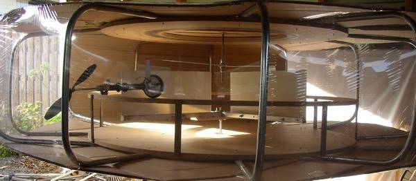

Even though I’ve experienced the evidence firsthand I’ve never quite been able to totally accept that the treadmill and turntable tests accurately represent a cart being powered solely by wind (like many others). So I’ve built a circular wind tunnel to test DDWFTTW in a “real” wind and the cart is only powered by moving air. It’s not high-tech but it works. Things move around quite quickly so you need to use slow motion or frame by frame to see what’s happening.
This video was taken during construction to show and explain the workings . . .
http://www.youtube.com/watch?v=simRdTslucs&feature=channel_page
This video is the wind tunnel and cart in action (the uploaded quality is very poor compared to the original) . . .

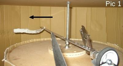

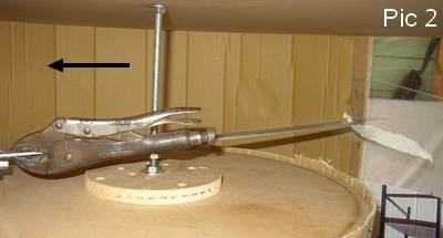

The cart not only beats the wind it also beats the vanes that create the wind! The series of images below show the flap each time it comes around and you can clearly see that the cart has advanced from vane 4 to vane 1. There is an image missing between the last two because the flap was in the reflection on the plastic and couldn’t be seen. The sequence represents eight revolutions of the cart. It wasn’t taken from the video posted but the same thing can be seen in that video as well.
http://www.accommodationz.co.nz/images/sequence.bmp
The vanes are turned by hand and it’s very easy to keep a constant speed. When the air is up to speed there is very little energy required to retain that speed so the vanes aren’t traveling much faster than the wind. The tunnel is totally enclosed and the air moves essentially as a single mass. The wind created would be at least as constant and stable as an outdoor wind.

This is actually the third design of wind tunnel I’ve built. The first one had a smaller diameter and the cart traveled so fast I couldn’t video it successfully. Here are a couple of photos I took of it in action. As you can see from the angle of the piece of rag Pic1 is slower than the wind and Pic2 is faster (arrow indicates wind direction). The wind was created by a four bladed horizontal impeller about two feet directly below the cart and the wind traveled up to the cart as a vortex.
The second attempt also worked and used the same impeller as the first. I didn’t like it however as there were too many internal pieces disturbing the airflow and it was hard to create sufficient wind in such a large area with a the impeller. Also looked more like an alien spaceship. Here is a photo . . .
I may try using the impeller in the latest design to replace the vanes and see how it works as the tunnel has less internal restrictions.

I’ve been very surprised (almost disappointed) that there hasn’t been any sceptical critsism of the circular wind tunnel. Not that I want to provide a bone to chew on but one of the concerns I had before testing was that the design of the vanes with a circular hole for the cart to pass through might have had some sort of venturi effect that would speed the cart up. The tests disproved this concern but just to confirm I’ve made a video using an impeller instead of the vanes. It’s very hard to get enough overall wind flow using the impeller but you should be able to see that the cart beats the wind even if only by a small amount. The immediate wind coming off the impeller would also be creating a faster wind in the top of the tunnel than the bottom. I may create vanes with just oblong surfaces at the very top and bottom. Would also make the flap and cart easier to see as they travel around.
Slow motion version of windtunnel3 (thanks Jeff)

Not sure if your “bite” was meant to be taken seriously or not. However - In this video I removed the top cowling so you can see all the moving parts. I give you my word that what you see is all there is. You don’t have to accept my word of course and I can‘t prove I‘m not cheating without showing you the equipment in person. You’re welcome to visit me any time you like.
When I first saw this claim demonstrated with the Jack Goodman outdoor video I though - “Yeah right, what a crock” and suggested he could be cheating (which he could have been). I then flip-flopped several times between believing it was possible and not. I realized that the only way that I could find out the truth for sure (for me) would be to build my own equipment and test it. I expected that my first test would disprove the claim but it didn‘t. Every test I’ve done has supported the claim and the final wind tunnel test proves the claim (to me) beyond any reasonable doubt. As the Mythbusters would say - “CONFIRMED”. The considerable time, effort and money I’ve spent on my equipment and tests has never been to prove or disprove anything to anyone other than myself.
Can you provide any proof of your claim that “it can’t work”? Why can’t it work?
If you’re not going to believe practicle, physical demonstrations of it working why should anyone waste their time creating an abstract computer program to demonstate it working? If you trust abstract computer programs more than reality you really should get out more. :wink:
ETA - You could always build and test your own equipment of course. If you did you would find out it actually does work regardless that you still might think it can’t or shouldn‘t.
