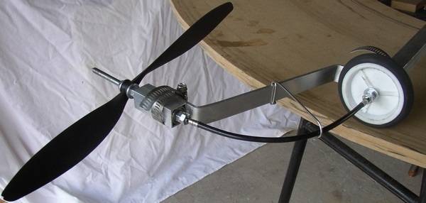

Re: your edit, are you saying the wheel is connected to the propeller by a flexishaft?
By a flexible cable.
Wind is air moving relative to something and/or something moving relative to air. If you ride a bike on a calm day you are effectively riding into a headwind. The cart moving with the turntable in calm air is moving in a wind no less than a cart stationary on the ground in an outside wind. It really doesn’t matter how the wind is created. It all boils down to the relative motion of air and something. The turntable surface moving relative to calm air is effectively the same as air moving relative to stationary ground in an outside scenario.
If this proves DDWFTTW, then so does a crankshaft, a right-angle drill, and the hands on a clock. In fact, any machine which redirects motion would be equally a “proof”. Sorry, I don’t see anything revolutionary here, but it is a nice turntable.
I just want to add that it is more than just a “nice turntable”. I can appreciate, as much as anyone, a really nice bit of mechanical workmanship. You obviously put a fair amount of time and effort into this. Many years ago I used to do hub integration design work on large satellite antennas with many precision rotating parts, moving cables and waveguides and it required a lot of mechanical skills as well as electrical work. You would be good at that sort of system integration. Back on topic; No this does not prove DDWFTTW. I think it comes closer to your original goal, which was to disprove it! What it shows is force redirection in mechanical systems is nothing unusual. A cart running on a treadmill, powered by a treadmill is no more unusual than any other type of force redirection, including your turntable. It has little or nothing to do with a cart going directly downwind, powered by nothing but the wind. What is happening here is that the force generated by the turntable against the wheel is greater than the rolling friction, which is obvious or the wheel would not roll! By stepping up the velocity of the turntable, that force can be made great enough to drive a propeller with enough force to also be greater than the rolling friction. That enables the cart to move in the opposite direction as the turntable. Nothing unusual is happening here at all. What I do find interesting about your design is that it leaves open the possibility to test for the runaway condition, or the terminal velocity, which obviously could not be done on the treadmill. Unfortunately, this probably falls under the category of “destructive testing” and I doubt if you want to do this with your new machine! But theoretically, if you increase the turntable velocity enough, the wheel and propeller should try to accelerate until either frictional forces or air turbulence become the only limiting factors. Things would get very interesting as you near the critical terminal velocity!
Some close up pictures of the various components, especially the wheel - prop interface would be nice. What is the wheel diamter and prop pitch? (The advance ratio is effective prop pitch / wheel circumference).

swerdna, whatever you have, it's a real brain teaser. Is the propeller driving the wheels, or are the wheels driving the propeller?
I have a suggestion to make to discover which way it is. Break the torsion shaft or cable in a convenient place and insert a piece of pliable rubber material. How the material twists will determine which is driving which. You will need to put some lengthwise stripes on it to tell which way it twists. And take closeup pics of it at rest and in action!
The wheel is driving the propeller. The thrust speed from the propeller is slower than the speed of the wheel. We've been calling (effective thrust speed / wheel speed) advance ratio, and it needs to be < 1 for a downwind cart, > 1 for an upwind cart.
