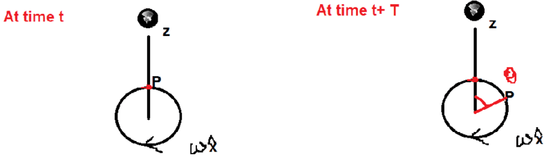

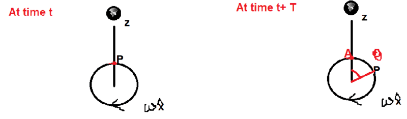

I assume that the particle is launched along the z- axis of the x-y-z frame which is fixed with the Earth and the Earth is rotating about the x – axis.
Wrt an inertial frame, the particle will fall on A.
The arc length between P and A is the required deflection.
Now, since the Earth is rotating with constant angular velocity, PA = ## \omega R T##, where T is the time of the fall.
Wrt an inertial frame, its acceleration is g ( let's take it constant).
Then, using ## s= \frac {at^2 } { 2} ## taking the initial speed to be 0.
We have, ## T = \sqrt{\frac {2h } { g } }##.
Is this correct?

There is no A in your figures ...

No, it is not correct. It is even stated in the problem that the deflection is to the east, ie, in the same direction as the rotation. (Last time I checked, the Sun rises in the east.)
I suggest that you examine your assumptions. In particular your assumption that the object falls straight down in an inertial frame.
And you still have not defined A in this thread.

I have defined A in the picture.

I have to measure the deflection wrt Earth frame. A person on the Earth will want the ball to fall on P, but the ball falls on A. So, for this person, PA is the deflection.
Isn't this correct?
Pushoam said:
The force acting on the object in the inertial frame is gravitational force (which is radial, in this case towards negative z- axis).
The Earth is rotating, but this doesn't affect the mass distribution.
I have assumed that the Earth is not orbiting. Is it this which is wrong?I have to measure the deflection wrt Earth frame. A person on the Earth will want the ball to fall on P, but the ball falls on A. So, for this person, PA is the deflection.
Isn't this correct?
No. The object is dropped from rest relative to the Earth frame so your assumption that it starts from rest in the inertial frame is obviously false.
