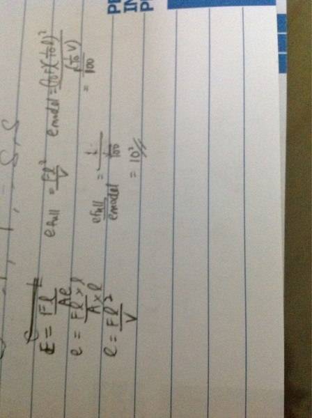

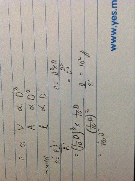

Okay, now that you have explained this to me , I kinda have a rough idea about the question. So here's my working:) is it correct?
However, I can't really relate the last proportionality you explained just now to me . In my working, I just times 1/10 to the force (load) , length and also volume. Is it the right way?

No. 1/1000 the force, 1/100 the area, and 1/10 the length.
Okay. Here's my new working. Is it correct ?
