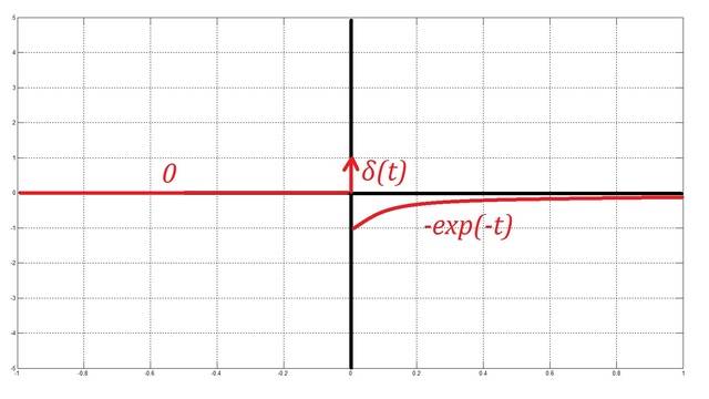

But when I differentiate, where do I exactly need to introduce the ##\delta(t)## into the equation for ##f'(t)##? :confused:
For t<0 we have (by product rule):
$$f'(t)= u'(t) e^{-t} + - e^{-t} u(t) = u'(t) e^{-t}$$
Do I need to rewrite this as ##\delta(t) e^{-t}## or just write it as zero (since the u(t) is constant on ##(-\infty, 0)##)?
Likewise for t<0:
$$f'(t)= u'(t) e^{-t} + - e^{-t} u(t) = u'(t) e^{-t} - e^{-t}=0$$
It is also possible to introduce delta here as: ##f'(t) = \delta(t) e^{-t}##.
Beut if I have a separate case for t=0, the derivative becomes ##\delta(0)e^{-0} - e^{-0} u(0)##. But I am not sure how to evaluate this since the u(t) is infinitely steep there, and does not have a particular value.
So I think this would be how the graph looks like for the derivative:
Is that correct, or do I need to scale the (t) somehow?
Do we not need to use (t) or something else in the expression for the antiderivative? Because the graph looks exactly the same as the one for the derivative (and we have a discontinuity at 0):
For t<0, ##f(t)=0 \implies F(t)= \int 0 = 0 + c##, and for t>0 ##f(t)= e^{-t} \implies F(t) = - e^{-t}##.
roam said:
where do I exactly need to introduce the δ(t)
f'(t)= u'(t) e^{-t} - e^{-t} u(t) $$And $$u'(t) e^{-t} = \delta(t) e^{-t} = \delta(t) \ \ ! $$It's so simple you would almost overlook it :smile: !
derivative plot looks good to me now; no scaling needed.

Would it be correct to write the following?
For t<0, $$f'(t)= \delta(t)$$
And for t>1, $$f'(t)= \delta (t) - e^{-t}$$
Whenever we have t=0, in both cases ##f'(0)=\infty##.
roam said:
Is that correct to write the following?
for t < 0 and for t > 0 ##\ \ \delta(t) =0\quad ## so yes, it's correct.
However, you should understand that you can't write "for t = 0 ##f'(t)=\infty##"
You can only think that :smile: -- and it's exactly to deal with that kind of situations that the ##\delta## 'function' is so useful: it allows us to write $$
f'(t)= \delta(t) - u(t)\;e^{-t} \quad\forall t \qquad $$Coming back to the graph of antiderivative: If I differentiate that, I get a ##-\delta## that isn't in f(t). so: no, the graph can't be right !
